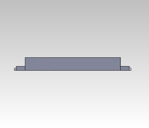

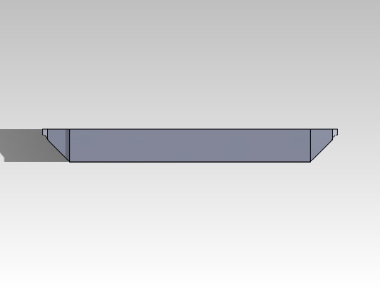

When I do a C Channel Coping Butt, Solid Works leaves a thin unwanted segement of material.  Is there a way to automatically elinate the small section of material or an I going to have to manually make a sketch and mirror it about the x and y axis for each occasion?

...mirror and extrude cut it each individual time...
