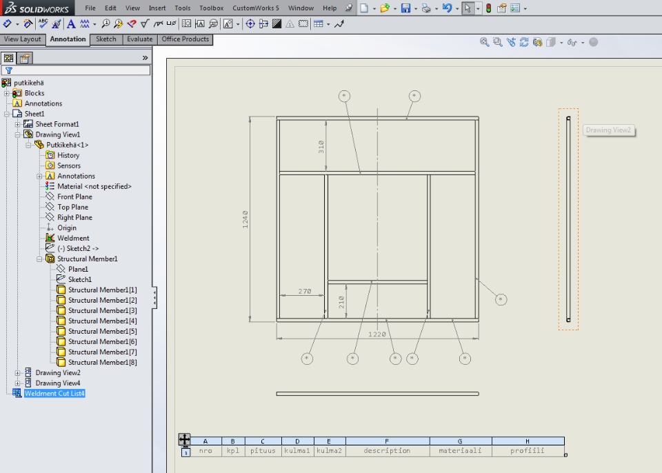

I just updated my SW to 2014sp3. I was working earlier with a simple frame made with weldments. Now I opened the drawing and part numbers and the cutlist is empty. They worked just fine before the update. What went wrong?
I also tried to make a new part from scratch, and the weldment cut list didn't work in that one either.
edit:
I attached files where I used weldment profiles. Can someone check whats wrong?
Ok now I got it, I had to manually update the cut-list:
Do I have to do this everytime from now on? Or can I update it automatically? There selection "Automatic" is selected but it didn't do the trick?
You have to (at least the first time) select update.
But if I remove the automatic tick, and the enables it again Cut list is broken. But you can just delete it and set it on automatic and then update.
