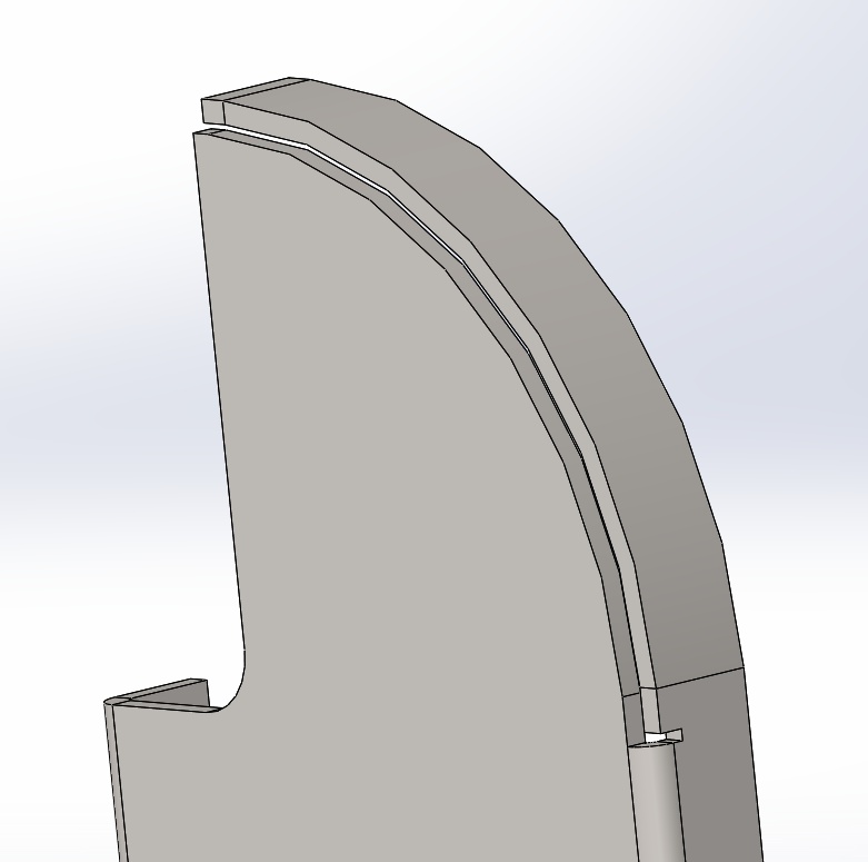

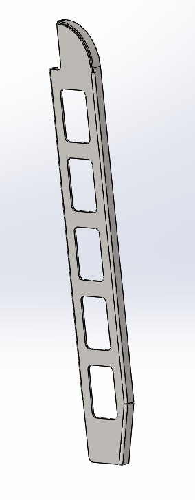

How do I create a welded corner in this sheet metal part in order to run a simple and accurate deflection and stress simulation? The void between the surfaces is not allowing me to run a proper simulation because the gap is welded during production of the part.
SolidworksParts And Features
Answers 2
LP
LP 2016-01-06 Best Answer
Hi Kevin,
I would create a solid body and then create a shell on it.
You can use your geometry and insert a new body without merging it with the original part,
and then in the analysis you can exclude the sheet metal body to analyse the "extruded/shell dummy".
When you apply shell mesh it should calculate much faster then with solid mesh elements.
hope this helps!
Leszek.
MP
MP 2016-01-06
Why not just sweep a weld bead along it?
