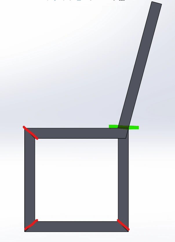

I am starting to work with welded structures and have encountered a problem. If anyone has a moment to help, I would be grateful.
I made a square structure from an 80x40 profile.
I would like to connect it with a 45-degree bevel.
what operations should I use to add a welded profile fragment while maintaining the bevel below (red), and weld this inclined profile to the plane (green) ?
I tried using the crop/stretch tool, but I lose the bevel.

Hi Mariusz, within the Structural Member command you should make the 4 square beams in one group, then add the upper right beam in a new group, but within the same command. This will allow you to select the corner (the small purple dot) and decide what order the trimming happens in order to keep a miter in all 4 corners of the square. See the attached file:

I did mine using two sketches and an extruded surface.
The main portion is built using two groups.
The upper left miter corner is added with a separate trim.
The sketch for the angled piece is added to and after the main frame. This member needed Locate Profile to correct its alignment to the main frame. A Trim was then added to extend it to the main frame.
I created a surface extrude for trimming (colored red).
The upper main frame member is extended using a Trim, which is possible because this member only uses one face of the surface.
The right vertical member is cut twice, so I used Cut with Surface to notch it. Hide the surface body when all done.
