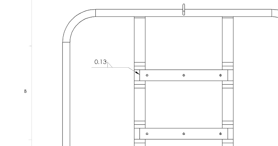

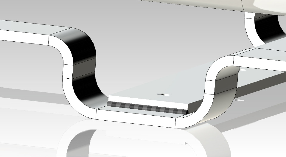

Weld symbols on wrong side?
I've reviewed weld symbol standards, and I'm finding that, when I'm adding weld symbols to drawings, it's placing the fillet weld symbol on the wrong side. I've used the Weld Bead tool for a Weldment to create these. Help? (This could just be a weldment newbie problem) I've switched the standard to ANSI (from ISO) as it's what the shop is most likely to use.

If you edit the weld symbol it is not allowing you to switch it?
You might be best served in deleting this one and creating a new one using the annotations
weld symbol.  That one I know for sure you can have on one side or both.
SF
SF 2012-02-16
Thanks, Scott!
I can edit it, but I was just going with what it seemed to be picking up automatically. Weirdly, it just seemed to fix itself all of a sudden, which I can't figure out. Not going to complain though, heh.
SM
SM 2012-02-16
No problem.  Glad to help.  I have seen at times that the software will do weird things
and a ctrl-Q will fix it or a restart will as well.
Anyway, I am glad your issue got resolved.
