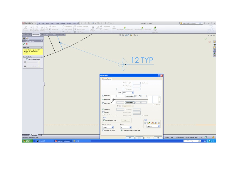

Hi,
Attached is a word doc screen shot of a weld symbol.
As you can see the peripheral symbol (the circle) which denotes weld all round is clashing with the fillet symbol.
Is there anyway to make these two further apart.
Highlighting and dragging doesn't do anything.
Thanks
Mark

Dear mark,
its working from my side, what SP you are using?
see the attached
Regards,
Satish Kumar
comment imagecomment image

Mark,
It is dependant on the font you are using. Mess around with different fonts in the weld callout field box and you will see the spacing change. Kind of ridiculous, I know.

MG 2011-05-17
Hi Nick,
Yes changing the font moved the circle away from the fillet symbol.
Why the the type of font you use has any bearing on how the detail shows up is beyond me.
Another great example of how SolidWorks handles drawings,
Thanks again Nick, would never have thought about the font being the problem.

Hi Mark,
I am using "Calibri" Font. also I have chaked with other fonts and its working fine with me.
which font type you are using?

Mark,
there is no issue after using century gothic font at my side. might font size and its placment matters
