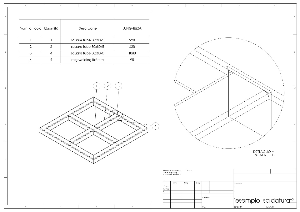

hi steve!
I am having the same trouble because I am always with a lot of job and very little time.
one way to bypass the trouble, have a pretty visual effect and calculate the amout of welding in a frame is the following:
create a new folder in welding elements named weldings then fill it with triangular shapes and name them welding, be careful to insert the description "welding" or whatever you fancy to see in the cut list. then use 3d sketch to draw weldings and then insert on it the welding profile you created.
when you make the cut list, weldings will be shown on it together with the rest of material.
I do it and is better than nothing
