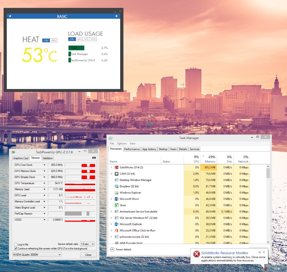

I'm having som wierd problems with SolidWorks installation. As you can se, everything seems to bee fine. But still SW keeps telling me, that I am out of resources. Has anybody an idea of what might be causing this problem?
The computer has been completly reinstalled from scratch twice (aka clean install). First time due to the installation of the SSD. The second time due to this problem, which i though was caused by a faulty installation of SW. As you can see the clean install didn't fix the problem
My computer is a HP EliteBook 8760w
- Intel Core i7-2620 quad core @ 2,7 Ghz
- 8GB ram
- Nvidia Quadro 3000M
- Samsung SSD

You may be hitting the RAM cap that your OS will allocate to one program. Not sure if that is what is going on but you may how to increase its allocation.
