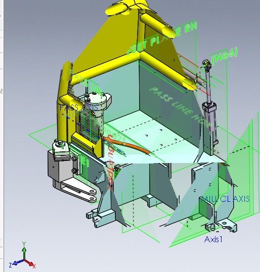

Weird behaviour moving around model...
This started happening today.
Not sure if I've inadvertently hit some combination of mouse keyboard shortcut or not.
Seems like model is getting sliced about some plane parallel to screen.
This does not happen when I open the parts in assy so seems to be file specific.
Looked in Options/Document nothing obvious there
Anyone have ideas ??

JR 2021-03-26 Best Answer
Make sure the Section button is not selected at the top of the window in the center.

Yes, it would be really useful, as long as they programmed it not to select anything in front of the Z-Plane which was a feature of this bug :-(

as noted, it's a grfx issue but,...I wish it were a feature.... that is a Z-Buffer option to look/slice into a model.

Looks like a graphics card issue.  Are you using an approved graphics card and driver?

Thanks Dan,
Got out of jail
I also don't know why it works ... But it does which is all I need

It happened to me before. I cannot remember correctly how do I fix this problem. As it is an assembly delete every part and see the remaining assembly this way you can find the part and reason.

Try turning off Enhanced Graphics.

I would address the behaviour to the GPU.
Do you still get the same with 'Show all types' disabled?
and, also, are you using 'Perspective' view?
