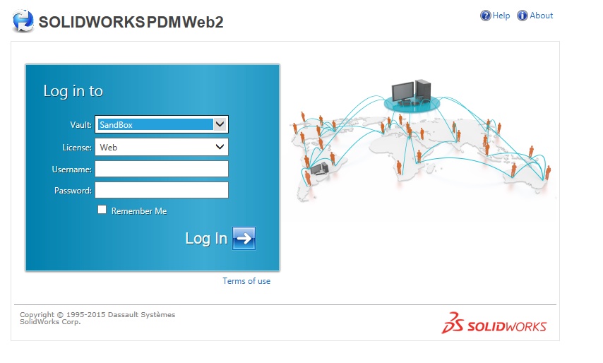

The Web2 log in screen has a dropdown to allow log in to appropriate vault. Our VAR set this up originally. Presently only the original vault and its Sandbox vault are in the dropdown. Does anyone know how I would add our latest vault to the Web2 vault dropdown menu?

Go find your "web.config" file - probably in your wwwroot folder where IIS is installed.
Edit the file in Notepad (I use Notepad++)
Find the VisibleVault line and make sure all of your vaults are listed. You'll need to separate them with a pipe | symbol.

As an alternative, you can also access this information directly in IIS - same end result
  1. Select the web application
  2. Double Click on "Application Settings"
  3. Double Click on the "VisibleVaults" line
  4. Enter in the names of the vaults with a | separating them

Thanks guys for your replies. It took me longer than I had hoped to resolve this. Our VAR finally came up with the simple answer.
In my case the solution was that I needed to get our server admin to set the new vault view on the vault server since that is where the Web view looks at the vault.
