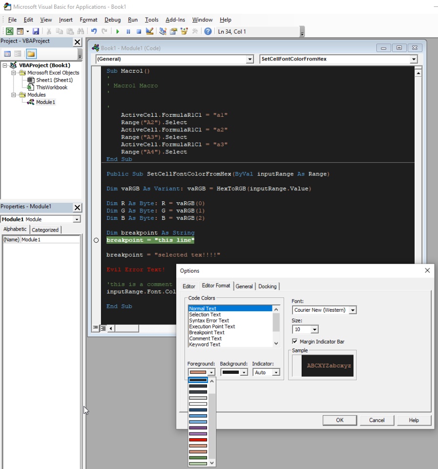

If I go into Excel to create a VBA macro, I can see that the VBE7.DLL hex edit was successful (this is with some manual adjustments to the text/background colors, but the point is that the colors I want show up in the drop down menu):

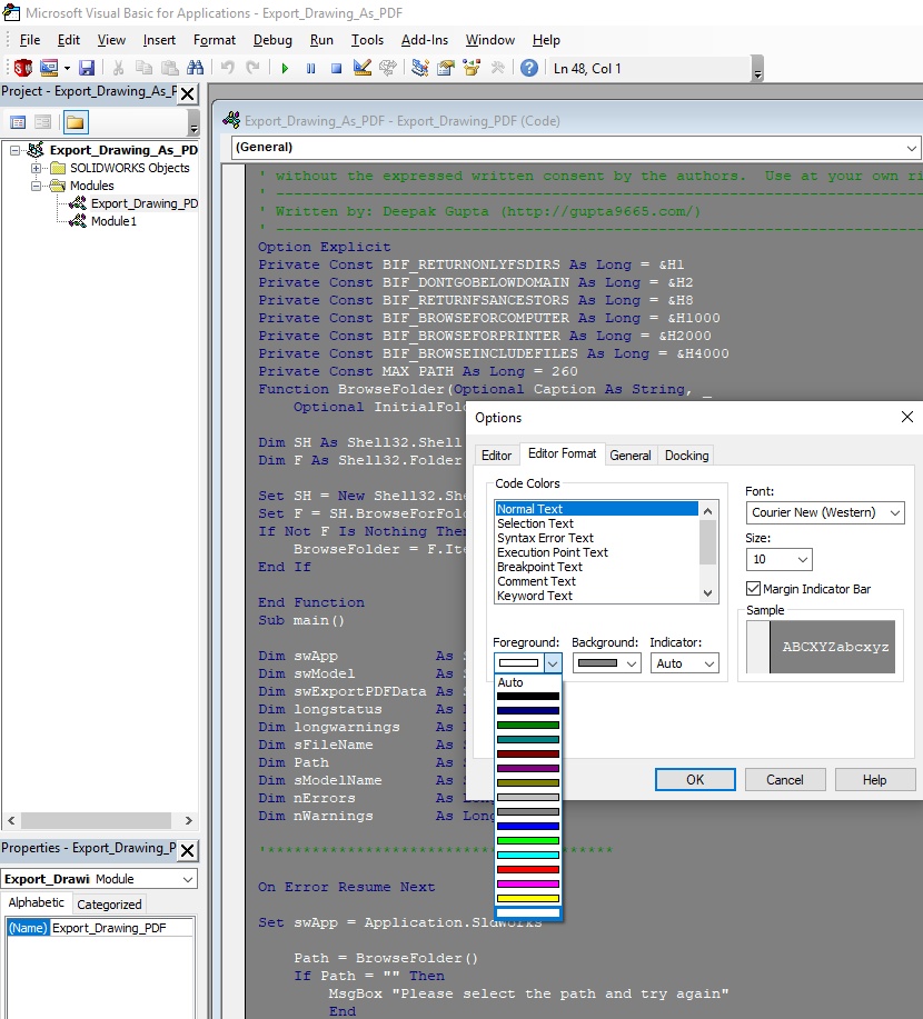

However, in SolidWorks, the colors are not quite what I want (note the drop down menu):

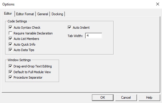

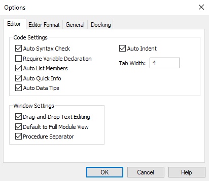

I also see that the Options box is different from Excel (first pic) and SW (second pic):

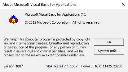

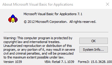

Do they not share the VBE7.DLL file? They both show:
Excel:
SW:
