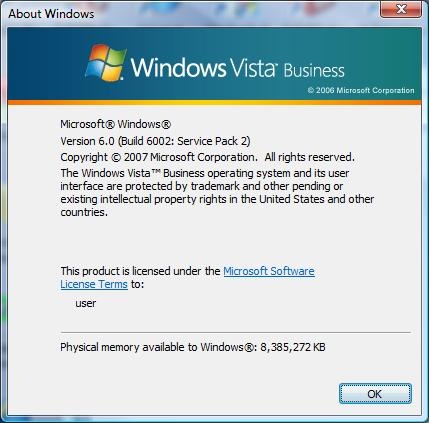

Sad that I have to even ask, but can someone on a Vista 64 machine help me out?  Go to Start, type "winver" in the search box and hit enter.  I thought my PC was Vista 64, but this is what I get...
Everywhere I looked on my PC, it simply says "Vista"; no reference to 32 bit or 64 bit (except with regards to the processor???).

On the bottom of that dialog it says you have access to over 8 gb of ram.  It's a 64 bit OS.  32 bit is limited to only 3.5 gb depending on your graphics card memory.

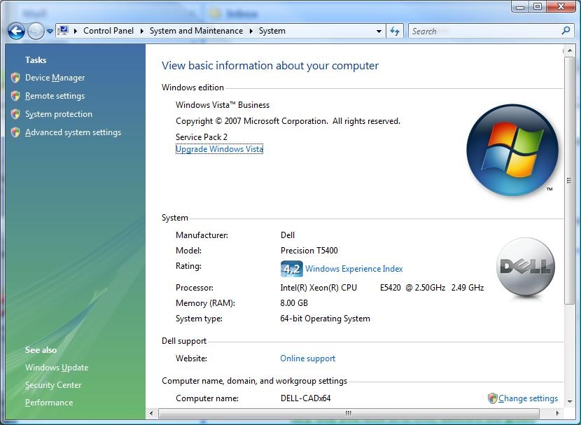

You can also find it by going to control panel/system and you should see it there.

Yeah, I've checked that some time ago (see attached).  I've had a lot of problems with this PC, and lately the only thing I've noticed is that when I get above 3.3 Gb or so (which seems like a red flag looking back at all the 32-bit limitation discussions), programs start crashing and I've been "self trained" to reboot.  So in looking specifically if my installed OS is 32 bit vs. 64, I can't help but notice it doesn't specifically say.  Much like a later model video card might have "Pro" or some other suffix that looking back to the original model wouldn't normally have.  Does that make sense?  I realize the system segment "sees" the RAM, but the area that reads "Windows Edition" makes no elaboration with regards to 32 bit vs. 64, so that's why I have to ask.

Under 'System Type' it says 64 bit OS in that picture.  Also, although I'm not sure it works, is there a 32-bit installation of Solidworks?  Check to see if it's installed in "Program Files" or "Program Files (x86)"
