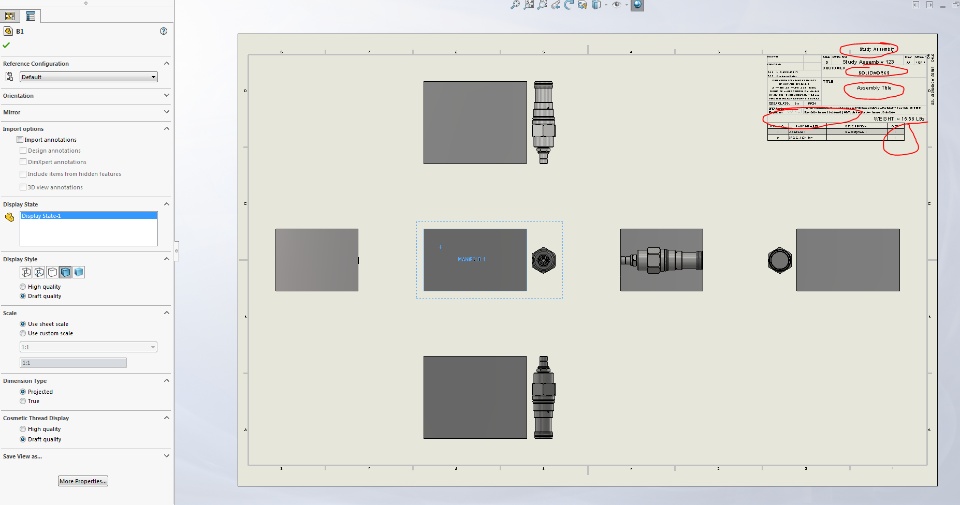

I am evaluating SolidWorks in order to decide move Inventor to SolidWorks.
I made a very simply assembly which include "Manifold 1" and Library part "RPGC_LCN.ipt" which is made in Inventor (that's very cool!).
I have following request and issues need someone help me.
1.     Now, for some reason, our company want to put the material of "Manifold 1" on title block (I know this does not make sense, but we do want do so). Question is:               How can I link the information from "Manifold 1" to the assembly in order I could put it into title block? I have lot of parameter need to do so, for example Customer, Title, REF, Project Number and so on (the circled in attached picture "Capture 1.PNG"
     In inventor, I could use iLogic to get all information from the 1st part in assembly and put into assembly then I do not have headache. But how can I do same thing in SolidWorks?
2. See attached drawing, the BOM width does not match Title Block. I know I can adjust it, but I want change the Style globally in order I do not need adjust every time.
3. Still in BOM, Item 2 is the Inventor part, the Part Number is the file number not part number. I do not want change every time because it is a library part. Do not tell me I need move all library components to SolidWorks Format.
4. When the view in "Shade with Edges" model, my library component is shown correct, but if I change to "Hidden Line Removed" model, most of line are removed even it is visible line.
Any solution or suggestions?

use the custom properties in the part to get the material.

the other part of your question may have to do with some grapic card info, and then getting your library parts set up to output what your looking for.

RZ 2018-05-08
I think my Graphics Card is pretty good, it is "Quadro FX 5800" model.
I do not have any issue for Inventor drawing.
And only in "Hidden Lines Removed" Display Style, the library component is not shown correct. In other style, the views are correct.
And the information of library component set all information as description, correct p/n and so on, but SolidWorks cannot get these information so far.

can you get a screen shot of the tree for the assembly....
all files in solidworks have properties
you can customize this as much as you want..
add materials ect.
then each property can be called out in a bom or have info go directly into a tblk.
then you may want to study up on the drawing options and see if they has some effect on the drawing views where your inventor part is not showing up right.
knowing what the program can do is half the battle.  Knowing how to do it and trying all the options and getting different results is the other half.  A good training class would be great or getting the VAR that you are purchasing the program from to come in and help you set up your templates for how you want to use the program may be another option.
