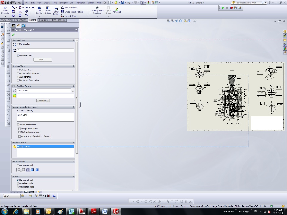

When i am working in SW drawing, some times the view boundary line is too big without any object on that area. Kindly find the attachment. In this view C2-C2, drawing from model is only in far right area. But, the most of the space in the left side is empty. I tried to find out that any hidden object is there. But, i couldn't. I am have the doubt that any base point of the block in this view is present in the left side. But, i have no idea to find out and make the boundary small. Kindly give idea.

Suresh,
What if you SolidWorks release and service pack?

Hi Matthew,
My configuration is SolidWorks 2011 x64 Edition, SP05.
Suresh
ML
ML 2013-12-10
There were some fixes to this behavior in SW2012 or SW2013.  For now, I might suggest that you simply save a view orientation on your drawing that is zoomed to the sheet.  Use this instead of Zoom to Fit if you wish to zoom to sheet.

Hello Suresh,
Did you search for hidden planes or axis.
A quick solution to this problem is to make a "Crop View" to the view with the boundary outside the sheet.

Hi Huma,
i checked for hidden planes and axes and found that no problem. So, for the time being, i will use the crop option. But, in solid works, we faced drawing hanging problem particularly when used cropped views with parital section. So, we are maiximum trying to avoid crop views and use detail view if possible.

I believe if you know the name of the view that is off the sheet say "Drawing view1" you can right click on that in the feature tree and select hide and the dashed box will disapear. Then do a zoom to fit your drawing to your display. Hope this helps. Tom

Dear Tom,
i tried as per your idea. But, it doesn't work. When i right click the particular view in model tree and select hide, whole drawing view is disappeared. Kindly explain.

hi suresh
this problem usually appeares to me also.
there might be due to some text that u can't see with naked eye like 'comma,dot etc; or also duehidden parts from the drawing sheet tree.
i fix these kind of problems by cropping the view within the sheet area so that it fits to the screen.
