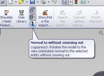

See attached, I actually have this function within Logopress3... very usefull apparently they thought so enough to write a routine to do it!
