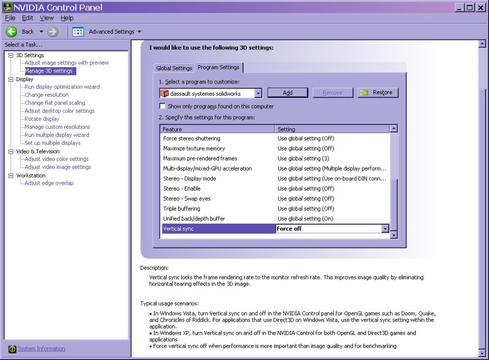

Is there a reason not to use the 'Dassault SystemesSolidWorks' global preset? I'm also concerned as to why verticalsync isn't off by default when you choose this profile if it is thepreferred setting. It's on 'Application Controlled' by default andI would hope that SolidWorks would then be setting vertical syncoff.
From my gaming experience Vertical Sync synchronizes the FPS rateof the game/program to your monitors refresh rate. If your videocard can run a game over 60 fps and your LCD monitor has a refreshrate of 60 hertz you are likely to see tearing across the screenwhen there is movement. With this setting on or off I have alwaysnoticed tearing in the SolidWorks window and the faster you rotatethe more noticeable it is.
SF
SF 2009-03-06
wow...thanks for shared
SF
SF 2009-03-06
Jeff,
The "DS SW global preset" should have it off by default, but justin case it isn't depending on your GPU manufacturer or card, it'sworth checking.
Your discription is exactly what I'm talking about and if yourmovement seems chopping, you are giving up performance forquality.

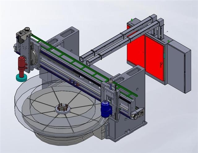

Mark,
Thanks for the tip. I have been working on a fairly large assemblyon my HP 8730 with the Quadro FX2700 card and have seen a noticedimprovement since changing this to "forced off"
Thanks again Mark,
NEOSWUG
SF
SF 2009-03-16
Dave, that assembly looks interesting. Do you mind if I ask whatthat application is pecifically for?
Don
SF
SF 2009-03-16
Don,
It's a large bearing grinder retrofit project.
Dave

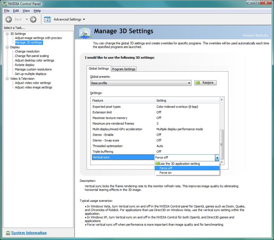

GH
GH 2009-04-28
where do you change this on a fx 1700?
SF
SF 2009-04-28
Greg,
It is in the Nvidia Control Panel (see image below). You can getto it from various spots, depending on how you set it up. You cango to the Windows Control Panel, click on the Nvidia icon in thetaskbar notification area (beside the clock) or right click on thedesktop.
