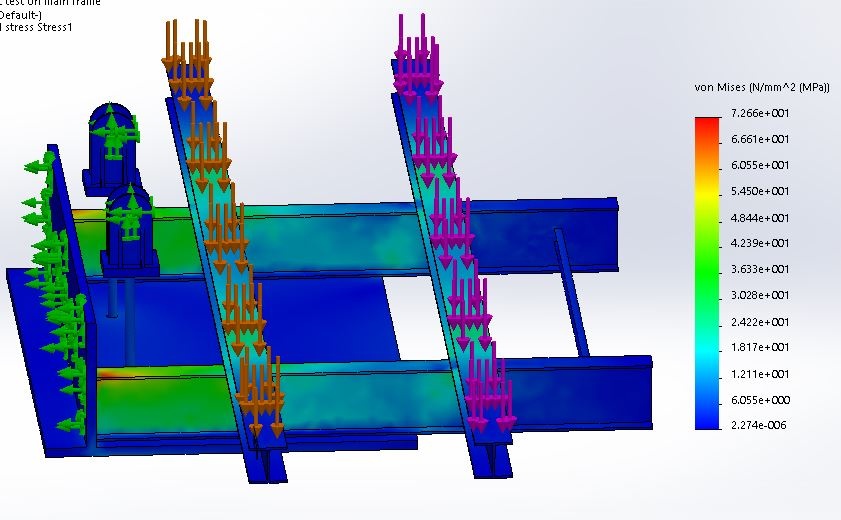

very low Von Mises stress
I'm fairly new to solidworks, had a query regarding simulation.  the simulation for my assembly shows very low von mises stresses range  2.6e-8 to 7.2e1 N/mm2. (see pic) Although material assigned  has high yield stress of about 300 N/mm2. i am probably missing something here. The stresses after running the simulation are nowhere near the yield or normal stresses. Would be grateful if you guys could help me out here
load on each of the beam is 50KN
connection - global contact
fixtures. - as shown in attachment
SolidworksSimulation

It is good to know that the material yield strength is not being used during calculation.
It is better to check the numbers for the Elastic Modulus, Poisson ratio and Mass Density.
Also about the Mass Density: have you defined Gravity in your study? This will take the weight of the construction into account. This can have a big impact when you have a quite heavy construction.
Furthermore it's good to check the mesh size. A too coarse mesh can result in a big error in stresses.
It's also good to perform a simple hand calculation, so you have a rough idea about the stresses you would expect.
Your maximum stress is 72 MPa, what would you expect?

Also check the input load. Are you sure it is 50kN "per item" otherwise it would be distributed between both beams and therefore half the load being applied.

Thank you Martijn, i have defined gravity and used a finer mesh. and the results are more realistic.

yes it was defined as 50KN per item. (each beam)
Its solved now. It seems like the mesh had to be finer and define gravity.
