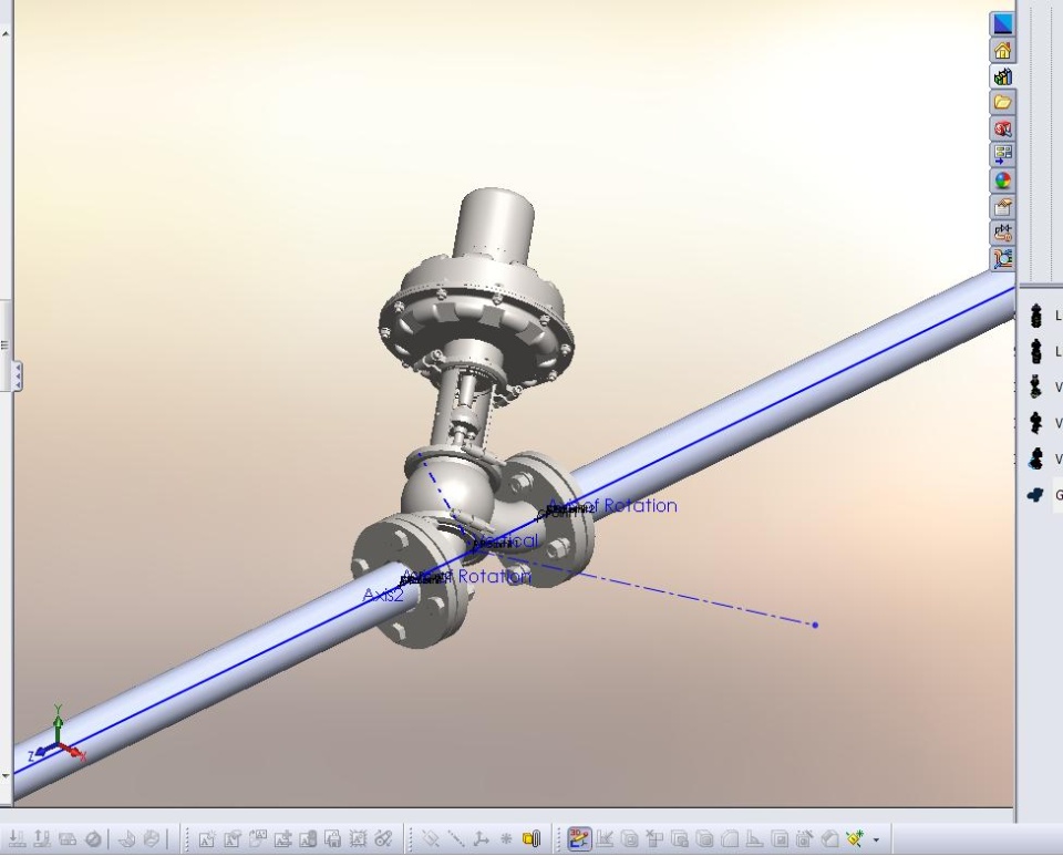

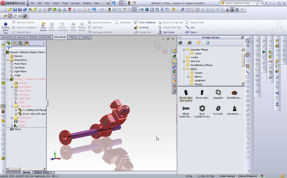

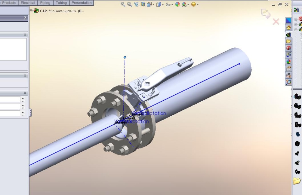

I have attached two snapshots, of two different assembly fittings and it doesnt seem to work to either of them. I cannot send the sw files because i need authorization to do so. If we cant solve this i'll see what i can do.
I have axis view enabled, what you see in the pics are the axes of the parts which make the assembly, meaning axis of flanges and the valve alone. Even though i have added a Vertical Axis in the Assembly it doesnt appear witrh axes view enabled. So, i believe that is the problem in a way. The construction method for the Vertical axis is to start a 3d sketch (2d sketch rarely is useful for me for creating Vertical Axis) and make a construction line towards an axis which usually is +y axis. Then a name it Vertical with a capital V and this is the last feature in my tree.
I used to have the same problem with parts when i initially started making my library parts and i solved it (to recognize Vertical Axis i mean) by running routing wizard for each routing part fitting. Then the axis worked. But in assembly routing fittings the routing component wizard isnt available. So i do what i describe above to create them.
I believe the problem is that the axis isnt recognized as Vertical for assemblies.

The problem was that i was creating the axis as a sketch (3d or 2d didn't matter) and naming it as Vertical. That is why i could not see it with axis view enabled, because it was not an axis, it was a simple sketch.
So, i went to reference geomety, created the an axis named it Vertical and it worked.
And of course that was the reason Vertical Axis could work with parts either in the beginning. Because it was a sketch and not an axis till i was going to routing wizard and actually "transforming" simple sketch to Vertical.
