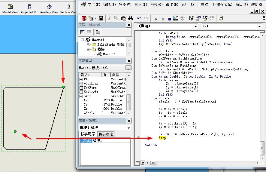

Vertex in sldprt → drawing point in slddrw
vertex in sldprt
Hope, drawing a point in slddrw
follow code, drawing a point  is error.

    Dim SwMathPt As MathPoint, Pt(2)
        With SwVertex
            Debug.Print .GetPoint(0), .GetPoint(1), .GetPoint(2)
            Pt(0) = .GetPoint(0)
            Pt(1) = .GetPoint(1)
            Pt(2) = .GetPoint(2)
        End With
        Set SwMathPt = SwMathUtil.CreatePoint(Pt)
        With SwMathPt
            Debug.Print .ArrayData(0), .ArrayData(1), .ArrayData(2)
        End With
        tmp = SwView.SelectEntity(SwVertex, True)
    Dim vOutLine
        vOutLine = SwView.GetOutline
    Dim SwXForm As MathTransform
        Set SwXForm = SwView.ModelToViewTransform
    Dim SwViewPt As MathPoint
        Set SwViewPt = SwMathPt.MultiplyTransform(SwXForm)
    Dim SkPt As SketchPoint
    Dim Xx As Double, Yy As Double, Zz As Double
        With SwViewPt
            Xx = .ArrayData(0)
            Yy = .ArrayData(1)
            Zz = .ArrayData(2)
        End With
    Dim oScale
        oScale = 1 / SwView.ScaleDecimal
        Xx = Xx * oScale
        Yy = Yy * oScale
        Zz = Zz * oScale
        Xx = vOutLine(0) + Xx
        Yy = vOutLine(1) + Yy
        Set SkPt = SwDraw.CreatePoint2(Xx, Yy, Zz)
        Stop
End Sub
how to get coordinates of selected vertexes on ... | SOLIDWORKS Forums  https://forum.solidworks.com/message/141098#141098#141098
Dim swMathUtils As SldWorks.MathUtility
Dim swXform As SldWorks.MathTransform
Dim swMathPt As SldWorks.MathPoint
Set swMathUtils = swApp.GetMathUtility
Set swXform = swView.ModelToViewTransform
Set swMathPt = swMathUtils.CreatePoint(swVertex.GetPoint())
Set swMathPt = swMathPt.MultiplyTransform(swXform)
'Now the coordinates converted to drawing space
Debug.Print swMathPt.ArrayData(0) & "; " & swMathPt.ArrayData(1)
