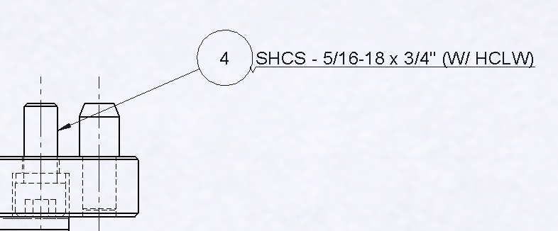

Currently my company uses a stacked balloon for toolbox items.  I'm trying to create a macro that selects all balloons on a sheet then checks to see if they are a toolbox item. & if so adds a stacked balloon to the original balloons, in a specific format.
What i have so far...
  • i can select a balloon,
  • I can determine if the attached item is a toolbox item.
  • I can add a balloon in the per-determined format.
Issues..
  • I can't seem to change the value of the stacked balloon to read the "description" custom property of the detail it is ballooning.
  • selection is based off a "recorded macro"... the add-too isn't following the "user selection" it using the "recorded selection"
Future
  • I would like run this on all balloons on all sheets..without user selection of the balloons...more automatic.
Warning(LOL): Code below is a Hodge-Podge of snippets i either have found or currently use...
