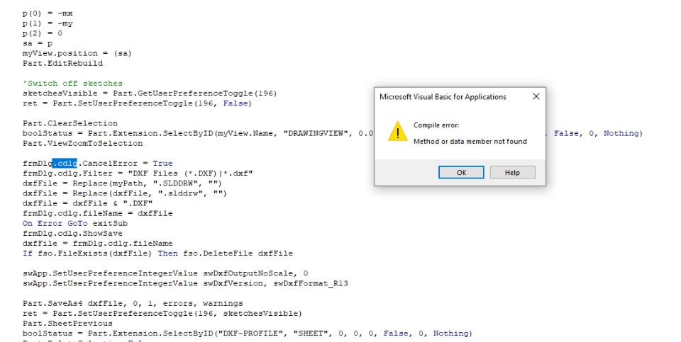

Its not working. I am getting a Compile Error.

I am also getting same error as Ravi Chandra Verma

Did you get this figured out? I'm getting the same error as you.

RV 2019-09-09
No Solution i have got till now.

Here is a link to one that works. You choose a view and it saves a dxf of that view in 1:1 after removing all dimensions.
 And don't forget to modify the macro where you want it to save the dxf files.
