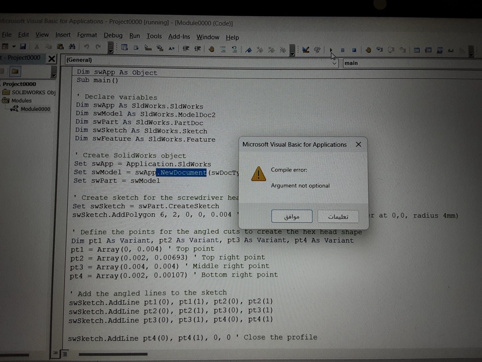

I think that since I can't deal with macro files, I have a ready-made code via artificial intelligence, but I couldn't run it. I need help on how to enter a ready-made code into SolidWorks 2023

If you did indeed get this code from a friend, the friend got it from an AI.  It is utter garbage and full of AI hallucinations of functions that do not exist, missing arguments, etc.
There is no way to make this code work.

AI is not good at programming. You'll have to 'hire' someone

How do I make the code work

To the right of your post's title is a menu. Select Edit to edit your original post and:
  1. Add some detail as to what you would like the macro to do, both in the body of the post and briefly in the post's title
  2. Paste your code as text in the body so that it be read
Save your edits.
Click the ? Help button in the upper right of SW and select API Help.
Use some of the commands of your generated code, assuming at least some of it isn't at zero value, and learn what API Help has to offer.
If there is a linked example, click and review it.
