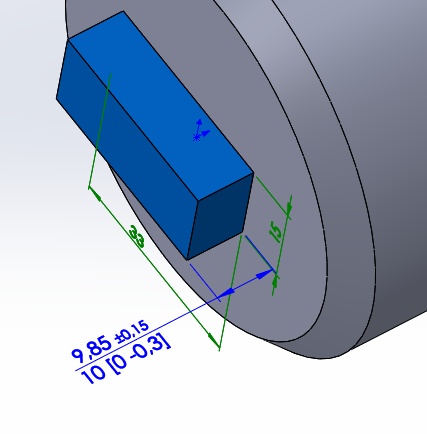

I've developed a "QuickEdit" tool (a Userform in VBA), when I e.g. select a face my tool detects the selected feature, get all dimensions related to that feature and allows to edit them (set a fit, modify tolerances, calculate the middle of the tolerances to create a CAM model, etc.), works pretty good.
But when I double click e.g. a face, I can see the dimensions in SW and obvious something is selected:
Unfortunately it seems not possible to detect what is selected, GetSelectedObjectCount2 is always 0, below is my test code. Any ideas?
Andreas.
