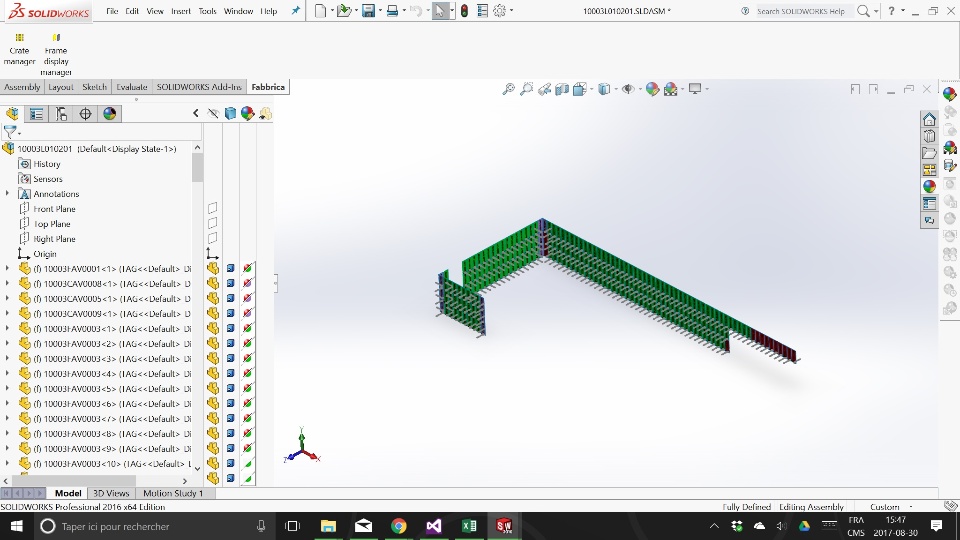

From what I understand there are basically 2 possible ways to do it (see below code and explanations of everything I did for both ways).  If anybody has experience with those functions, a piece of working code or tips for me, it would be greatly appreciated because I am really stucked right now.  See also screenshots of one of the assemblies I am working with below.

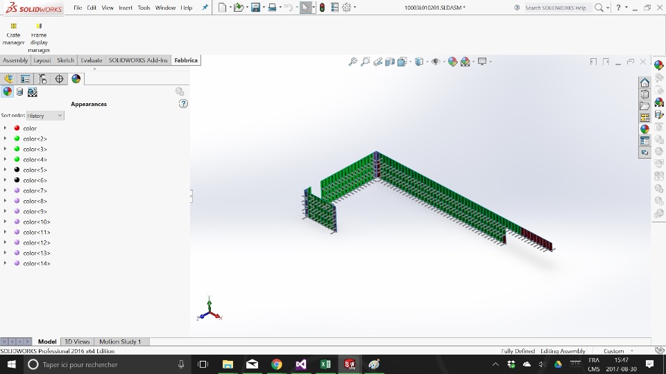

The first problem is to get the ids of the appearances (iRenderMaterial interface if I understand well).  When I use the following code, I get very inconsistent results accessing the RenderMaterial objects.  Meaning that I never get all the appearances contained in the assembly.  In assemblies that contains many appearances for many components, sometimes I can not access any rendermaterial object, sometimes I can access a few, but I never get them all.

          'using GetRenderMaterialsCount2 gives inconsistent results, for any of the 3 syntaxes below.
          'In assemblies that contains many appearances, I sometimes get 0,
          'sometimes another number, but never the appearance count that I can see under the appearance tab in SolidWorks

Screenshots of the assembly
