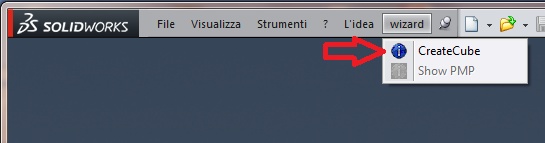

Vb.Addin Missing icons in menu! Why???
Hallo
I have a problem with icons in my Addin, they are missing in menu, like in the attached image.
This is my addin code (it is standard):
#Region"UI Methods"
Sub AddCommandMgr()
        Dim mdGroup As ICommandGroup
      If iBm Is Nothing Then
            iBmp = New BitmapHandler()
      End If
Dim thisAssembly As Assembly
        Dim cmdIndex0 As Integer,cmdIndex1 As Integer
        Dim Title As String= "wizard"
        Dim ToolTip As String= "wizard"
Dim docTypes() As Integer = {swDocumentTypes_e.swDocASSEMBLY, _
                                       swDocumentTypes_e.swDocDRAWING, _
                                       swDocumentTypes_e.swDocPART}
        thisAssembly = System.Reflection.Assembly.GetAssembly(Me.GetType())
        Dim cmdGroupErr As Integer= 0
        Dim ignorePrevious As Boolean= False
Dim registryIDs As Object= Nothing
        Dim getDataResult As Boolean = iCmdMgr.GetGroupDataFromRegistry(mainCmdGroupID, registryIDs)
Dim knownIDs As Integer() = New Integer(1){mainItemID1, mainItemID2}
        If getDataResult Then
            If Not CompareIDs(registryIDs, knownIDs) Then 'if the IDs don't
match, reset the commandGroup
                ignorePrevious = True
            End If
        End If
        cmdGroup =iCmdMgr.CreateCommandGroup2(mainCmdGroupID, Title, ToolTip, "", -1, ignorePrevious, cmdGroupErr)
        If cmdGroup Is Nothing Or thisAssembly Is Nothing Then
                 Throw New NullReferenceException()
        End If
cmdGroup.LargeIconList = iBmp.CreateFileFromResourceBitmap("SwTools Sketch wizard.Toolbar_large.bmp", thisAssembly)
cmdGroup.SmallIconList = iBmp.CreateFileFromResourceBitmap("SwTools Sketch wizard.Toolbar_small.bmp", thisAssembly)
cmdGroup.LargeMainIcon = iBmp.CreateFileFromResourceBitmap("SwTools Sketch wizard.MainIconLarge.bmp", thisAssembly)
cmdGroup.SmallMainIcon = iBmp.CreateFileFromResourceBitmap("SwTools Sketch wizard.MainIconSmall.bmp", thisAssembly)
Dim menuToolbarOption As Integer = swCommandItemType_e.swMenuItem Or swCommandItemType_e.swToolbarItem
cmdIndex0 = cmdGroup.AddCommandItem2("CreateCube", -1, "Create a cube", "Create cube", 0, "CreateCube", "", mainItemID1, menuToolbarOption)
cmdIndex1 = cmdGroup.AddCommandItem2("Show PMP", -1, "Display sample property manager", "Show PMP", 2, "ShowPMP", "PMPEnable", mainItemID2, menuToolbarOption)
