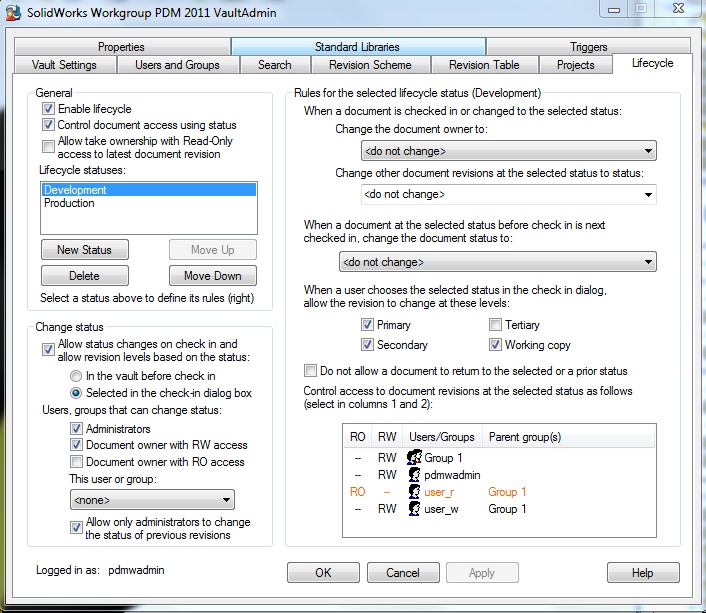

Is it possible to move a Part/Drawing file from a Development # to a Production # without breaking the connection?? In other words, I want this:
Part XXX-000 Rev 02 in the Development Folder under "Development" status
to become
Part XXX-XXX0-X0000 Rev A in the Production Folder under "Production" status
keeping the history of this part in tact.
Also - since it moved to Production the "Development" part is no longer. How do I "de-activate" it (perhaps read only)??
Thanks.....
MattP

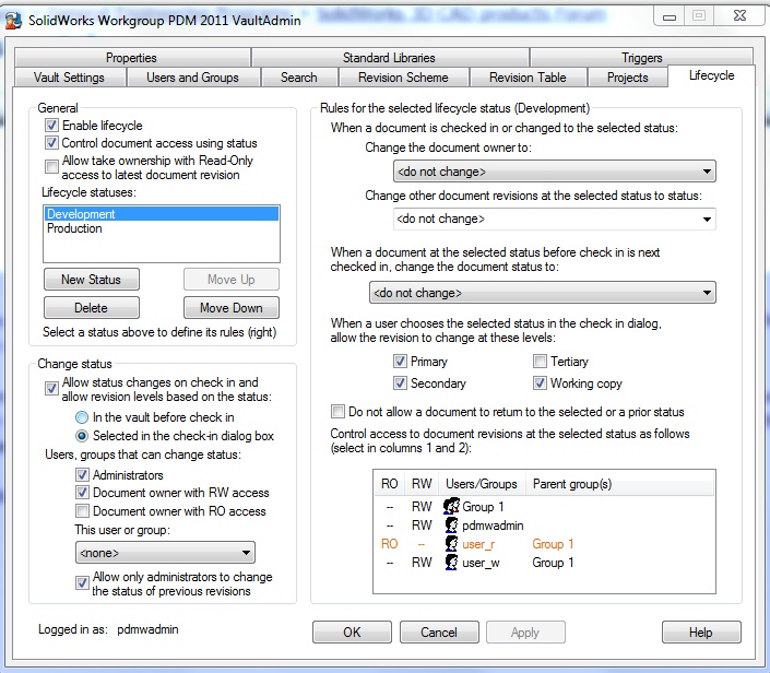

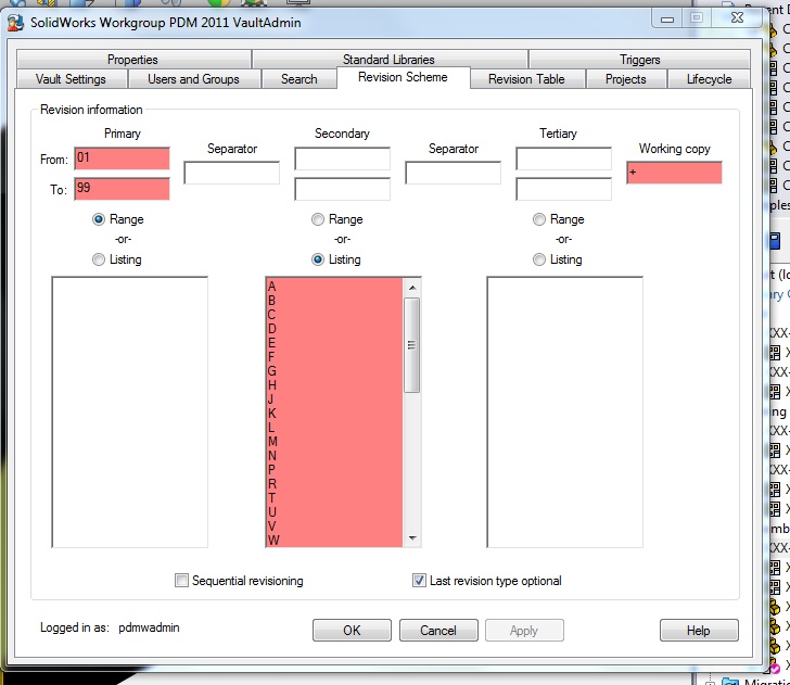

Note: I attempted this as a "Save As", but 2 problems arose. #1 it would NOT allow me to check the part in as a Rev A although I changed Status and Project Folder; #2 it has no history once I "Save As" (normal to anyone who has used SW for more than 2 days)          See the attached screen shots for my VaultAdmin setup

MP 2011-12-01 Best Answer
To All;
no it can't be done in PDMW.
The solution is to do the "save as" method, with your Production drawing's Rev Table referencing the old Development P/N.
