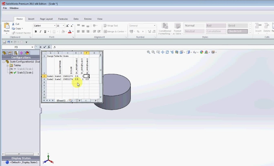

Create a design table and then control the scale factor in there.

What are the steps of putting the value into the scale function?
DG
DG 2013-09-12
Open your part file with the configurations. Now insert the deign table and set it to auto create. Now the column heading for scale feature will appear and you can set values as required. (works in SW2013 not sure about SW2012).
Attached a quick video and SW2013 file. Please note that in the example I've not used uniform scaling just to show that you can control all 3 axes with design table.
