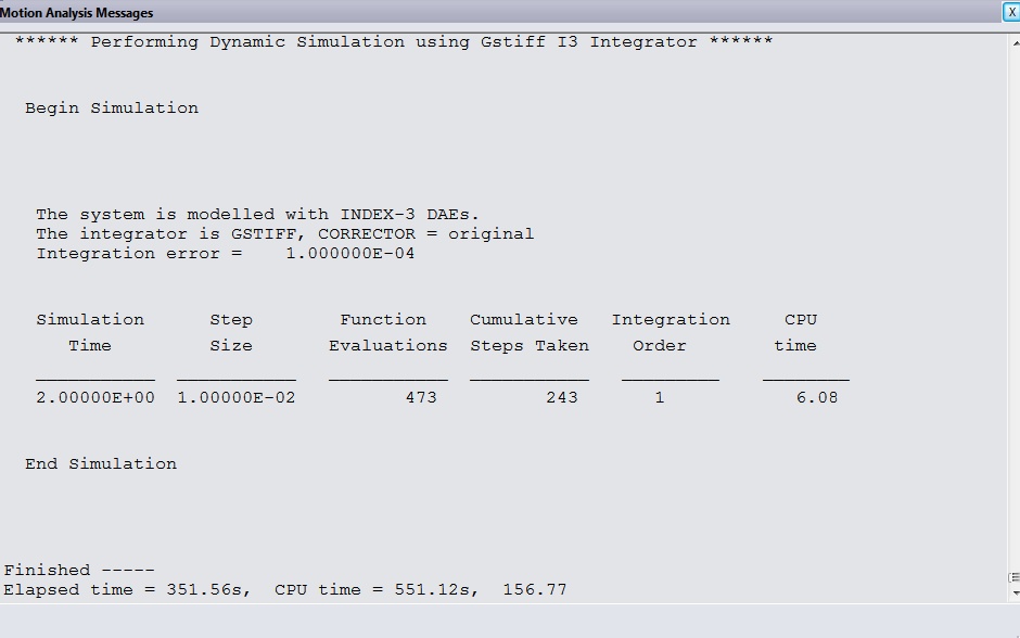

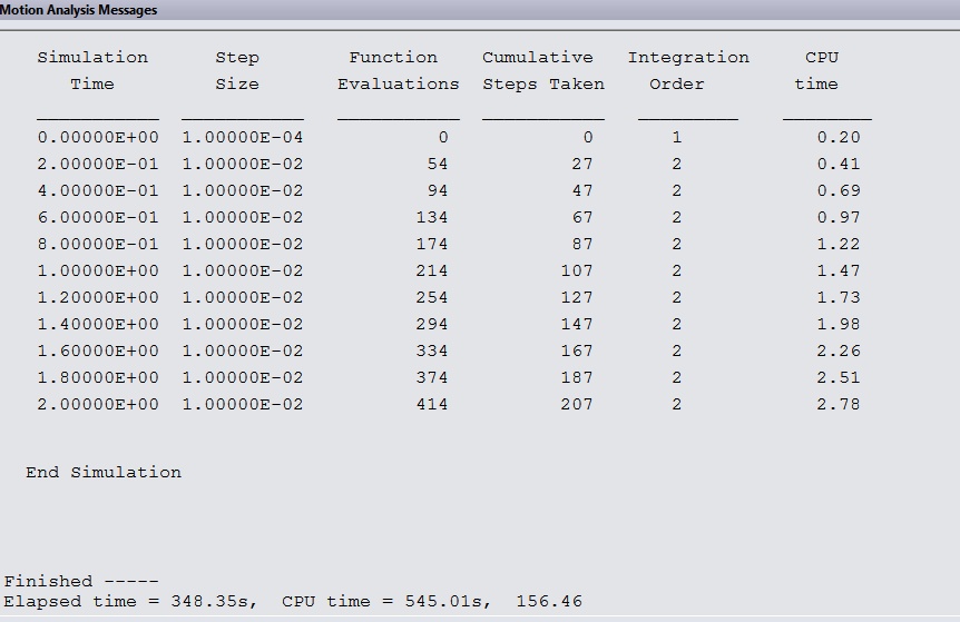

Above is using Motion without externally modifying the rotation position of the part, below is using the VBA
script to start the simulation and calculate the position of the wheel.  It takes more than twice as long and restarts
the simulation at each step.
Does anyone know if there is a way to prevent restarting the simulation?  Also, any other tips and tricks to
speed up simulations?
