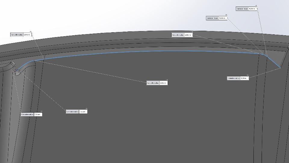

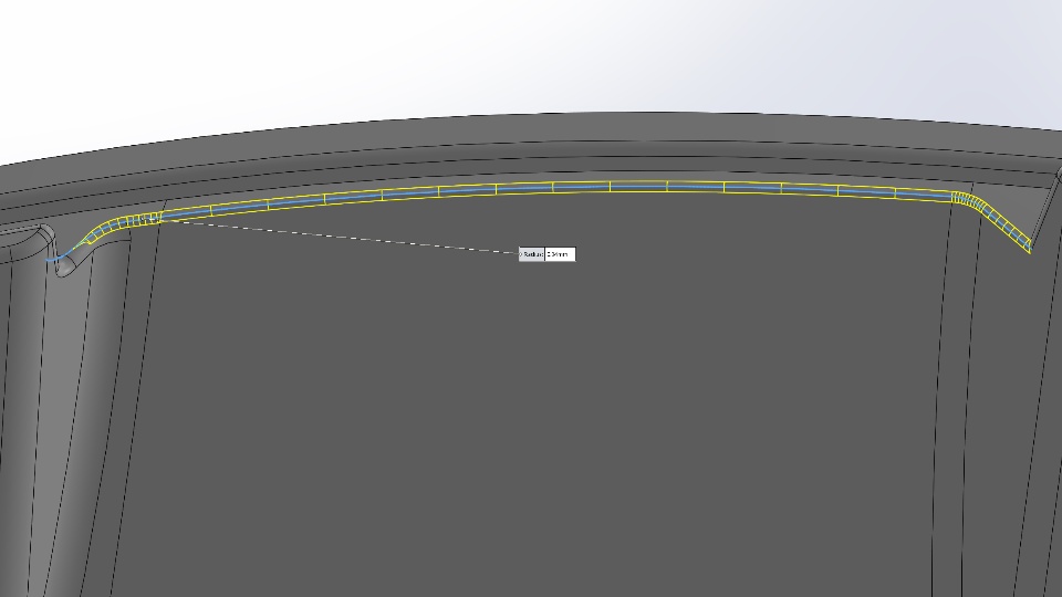

Hi everybody,
I've seen it more than one or two times an I don't understand what the reason can be (if it's not just a bug).
Imagine an edge with a regular 4mm fillet running along it with no trouble. Then we try to run the same 4mm fillet by the variable fillet option assigning 4mm to all points and the fillet is not working (usually due to the "geometry condition")
What is the difference between one and another way? What am I missing here?
Sometimes I need to do it with the variable option in order to assign a common value and then change one or two points and this issue is very frustrating when it happens so I can see how the regular fillet works but the variable one it doesn't.
You can find the screenshots sample file attached.
1. With the normal fillet option:
2. With the variable fillet option
Thank you very much!!

I think the fillet failed due to the geometry of your part (on both sides with round corner)
If you delete the round corners, it should work

This round corners are definitelly difficulting the filleting of this edge... In fact this is being treated into an specific thread you can see HERE if interested.
Even though my question is not exactly how to run a bigger or variable fillet here but what is the reason for the variable fillet not to run a 0.34mm radius with the same conditions that the basic fillet is actually running also a 0.34mm radius. Shouldn't it be the same result?
This may seem a bit theoretical (so the practial situation will be solved deleting previous radius or running the basic fillet instead the variable one, depending on what we are building) but I think it may be a good point to have a deeper comprehension of the fillet feature.

It looks to me (based on your pictures only) that the variable fillet has selected more edges than the regular fillet.
Here, the regular fillet looks like it stops here at the arrow.  Even though the rest of the edge is blue, it looks like tangent propagation isn't selected.
Here, the variable fillet extends all the way to the corner and beyond, which tells me that there is more of the edge trying to be processed by the variable fillet.
What I am trying to say is that I suspect that the conditions are NOT the same between the two.

This should be answered by SW developers of how they programmed the constant vs variable fillets but for sure the weird corner is more likely caused the issue here for the variable fillet

Hi Dan,
I should have shown the panels in both cases, I'm sorry.
Conditions are the same since I first select the edges and then tried to get both previews into the same feature's property manager.
As you noticed, the same edge combination is in blue, but tangent propagation is also active in both cases (I don't know how it affects to the result if at the end I'm selecting the same edge combo manually).
In the first picture the fillet stops, but not suddenly at all, so there is an small transition because of the continuity between the second combo face (horizontal quad) and the long narrow ribbon. They are tangent at the begining (left end) but not at the right end of the rectangle.
Here you have both property managers:
Thank you!
