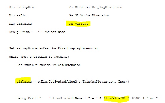

I'm getting a Type Match Error using
<p>Dim ArrDara(2) as Double</p><p>[...]</p><p>ArrData(1) = swDimension.GetSystemValue3(swThisConfiguration, Empty)</p>
In one of the examples - 2013 SOLIDWORKS API Help - Get Dimension of Distance Mate Example (VBA)
dimValue is declared as a variant - presumably an array of doubles
So I got to thinking as I am only interested in the value in this configuration and this is during my rebuild function - I want it to be as quick as possible.
Would I be better using the obsolete property (It still works) or could this lead to problems going forward?
