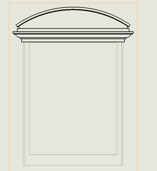

So with all this as a preface, I am attaching a sample view of an assembly I am working on. This is a product for a company I was recently hired at where they are using solidworks, and now that I am not using solid edge Id like to be able to bring back that technique of assigning drawing items to layers with specific settings and also be able to create overlay views to show specific details.
In the case below, I was able to place either specific parts or entire assemblies into a layer. The issue here is that this affects the entire drawing, so if I have 10 sheets I cant have unique layer settings for each sheet and its views because the settings are applied to the parts and not the view.
