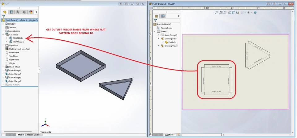

Using C# how to get cutlist folder name from View in a drawing?

                           //PRINT NAME OF CUT LIST FOLDER FROM WHICH FOLDER FLAT PATTERN BODY BELONG TO
