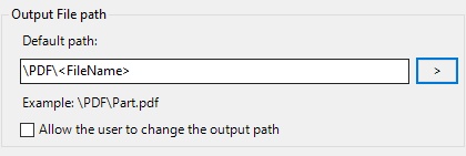

Hi All,
I've been trying to modify the standard Office to PDF task in order to convert word documents to PDF and save a copy inside PDM (as per standard functionality) and a copy outside PDM. The copy to be saved outside should be saved in a dropbox folder to easily send a link to our external suppliers. However this folder location will vary for different users, so I wanted to allow the user to specify the location when the task is run. I've tried to reference S-061104 and other forum posts however all the information I find seems to reference the Convert task (SWX to other file formats) not specifically the Office to PDF task and the scripting looks completely different.
I presume I need to combine the file path selected in the input card and the file path/file name specified in the task in some way but none of my attempts have worked. See below where "Selected_File_Path" is the variable the path is saved to from the input card.
Any help would be greatly appreciated.
