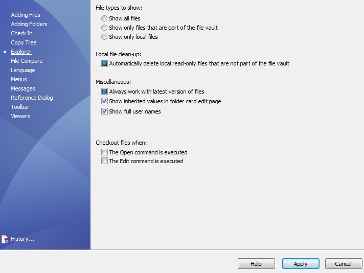

So when editing settings per user (or for all users), I'm able to have it make the changes for either indivuals or everyone all at once, but groups won't seem to connect.
I'm interested in having different settings for users based on groups (Like who can see local files, and who can't)
Below is an image showing the settings screen that I'm talking about.
It's customizable for individual users and ALL users at once, but not for groups. Does anyone know how to let you change these settings for groups?? I mean it lets you push the buttons but it doesn't actualy implement anything.

Settings are stored at the user level, not in groups. If you make a change to a group, those changes are pushed down to all the members of that group.

interesting.  Maybe mine has a bug, because when I change the group settings, nothing is updated on the individual level. And when I go back to check the group settings, they're exactly the same as before I pressed "ok".

Don't think that is true for "settings" though?
JG
JG 2012-05-17
Hi Jeff -
You are correct. It is not true for "settings". (Right click Users > Settings)
If you right click on User > Setting and set some options (ie: Explorer > File types to show > Show only files that are part of the file vault), then add a new user - the Setting will not be applied to the new user.

Thanks for the response Joy. There's no way to apply "settings' from groups though? It always has to be users?

As a work around we have a numbe of users set-up with our desired User Settings.  When a new user is created we use the 'Copy Permissions and Settings from" option to grab our desired User Settings.
     This does help if those settings then need to be updated though.

You can select a group, RMB and select Settings...but, if you add a user to the group after applying some settings, you'll need to repeat it for the new user.

So it will apply those settings to the current users of the group? But anyone added to the group won't have those settings applied? I'm just making sure I understand you correctly.

Charley, that is correct.
