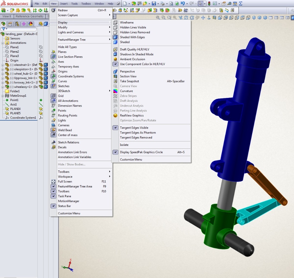

Is the Use Component Color in HLR/HLV working correctly?
I seem to get less than desirable results.

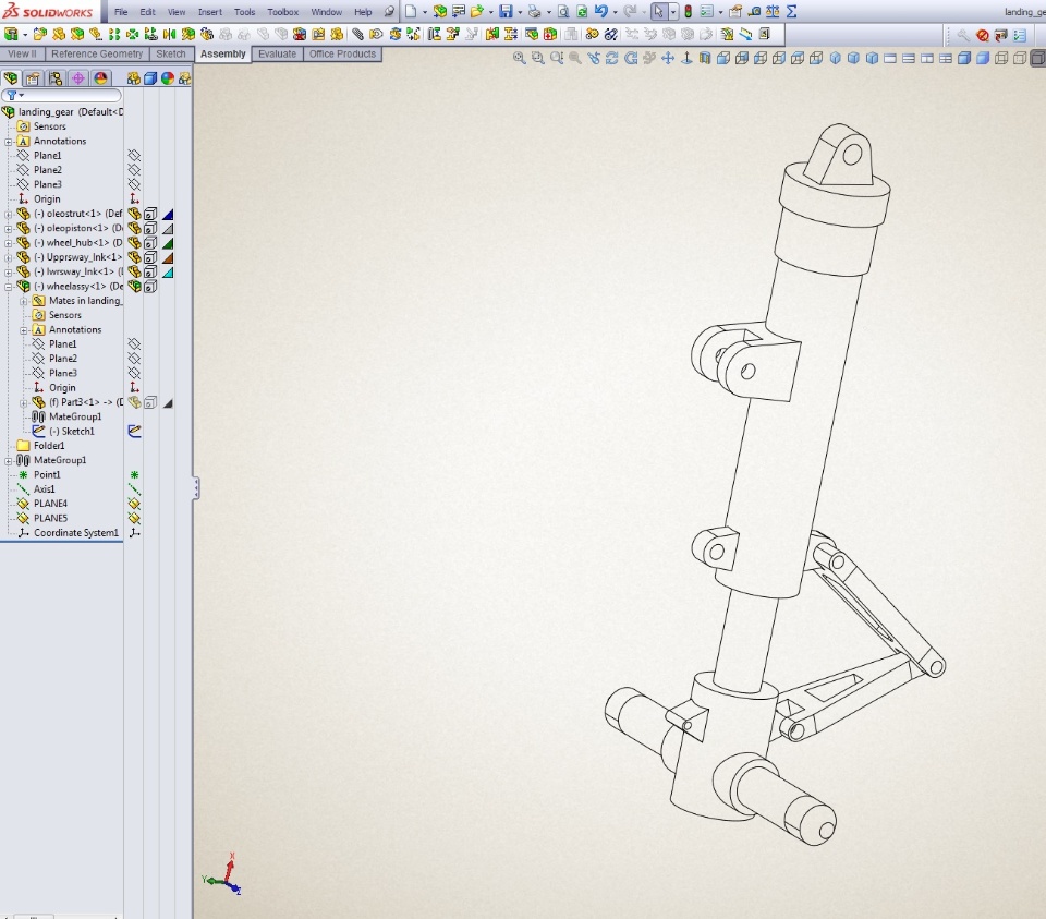

toggle to HLR
where's the color?
as you can see there are no overrides.
one would think this is a seemingly easy task

The HLR/HLV colors are set at each component. for a test open a component Got to tools, Options, Document properties model display. The set the option below. then go to the assembly and set to HLR/HLV
Hope this helps
Kevin
