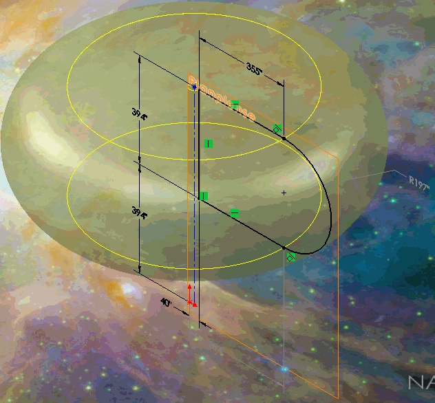

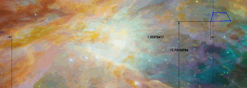

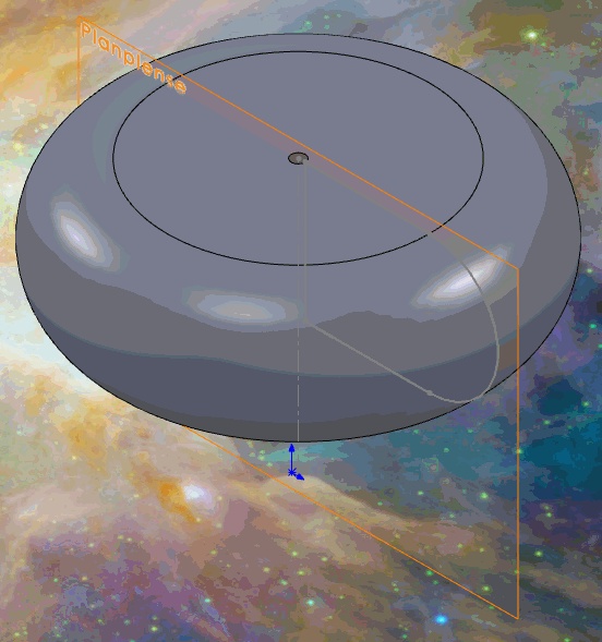

Hi all I Have a problem with a macro .
I want to make a cut revolve out from a sketch but the problem is that the lines with the desired cordinates i want doesnt get good done
when i run this macro  it generate a sketch with X cordinatesthat always take 0 value
