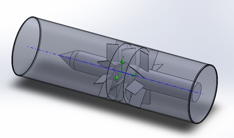

I am a college student, and as part of our final semester project, we need to analyse an axial flow fan.
As per my knowledge, it needs a very refined mesh, at least near the rotor blades.
So for that, i have used Local Initial mesh to refine meshes in my rotating region.

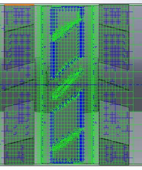

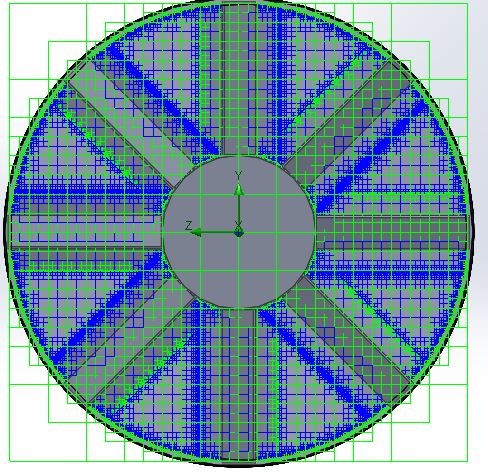

so the problems are:
1) Mesh doesnt seem to be fine enough to give accurate results. i have tried many different settings, but no effect. mesh count has gone up from 10k to 280k, but mesh still isnt fine enough near the rotor blades. and if it wont be fine there, the result can not be proper.
2) The results i am getting are very very variable. i want them to be precise at least, if not accurate.
3) the way solidworks adapts a very fine mesh in fea analysis, specially near curvatures, such thing dont seem to be happening in flow simulation.

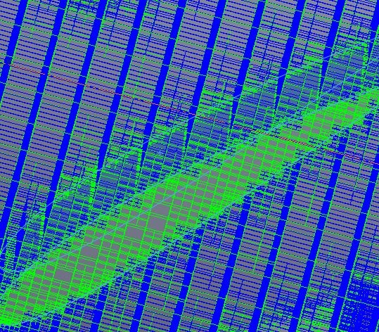

I'm working on a propeller with two blades, and can't find a way to make a denser mesh around the blades. Using mesh 3D view we can see that mesh is pretty poor on the rotor.
I've tried playing around with initial mesh but what I get is as show in the picture :
it seems not to affect the meshing on the object :s
Is there a better way? Is it possible perhaps to create some sort of a "phantom" solid that contains the propeller within its volume and to mesh the object? It's possible with sw simulation with a dedicated "mesh" button but can't seem to find one in flow...
