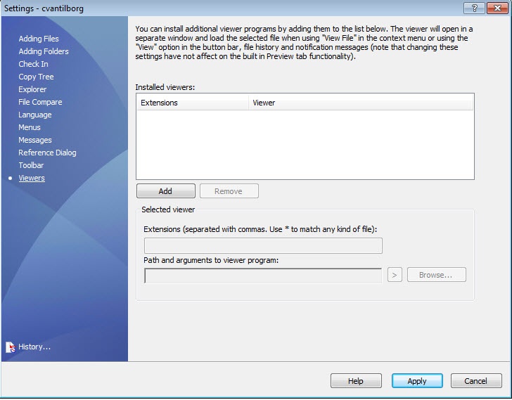

This year I decided to try to upgrade it from the database.  To that end i wrote this SQL script
update dbo.Settings
set dbo.settings.Value = '* %ProgramFiles%\\SolidWorks Enterprise PDM\\FileViewer.exe "%1%" sldasm, sldprt, slddrw, dwg %ProgramFiles% (x86)\\Common Files\\eDrawings2012\\EModelViewer.exe "%1%"'
from dbo.Users left join dbo.GroupMembers on dbo.users.UserID = dbo.GroupMembers.UserID
left join dbo.Groups on dbo.GroupMembers.GroupID = dbo.groups.GroupID
left join dbo.Settings on dbo.Users.UserID = dbo.settings.UserID
where dbo.GroupMembers.IsMember = 1 and dbo.groups.GroupID = '@DesiredUserGroup' and dbo.Settings.VarID = '16'
The intention here to was to update the viewer string for everyone in our Engineering user group to a known good value.  Since I know that all of our Engineers user 64-bit machines I can at least do this much.
The script does work, it that is updates the values in  dbo.settings .  However when I go into the UI after running the script I get this:
Obviously I am missing something here.   When I look at all the Settings in SQL for that user, I can see that I did update the viewer setting, but obviously I am missing something.

Has anyone worked with this before?  How do you upgrade all your viewers?
