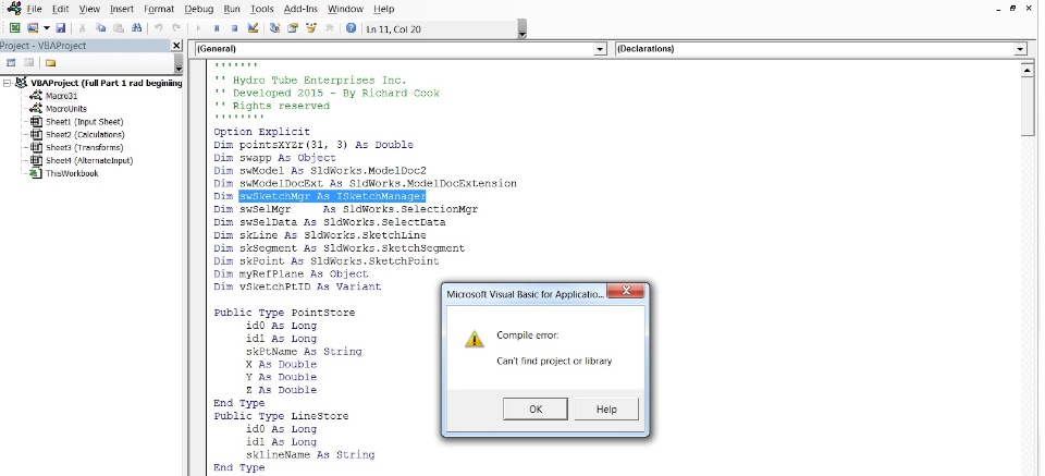

I have a macro that is pretty involved. Was running fine with SW2105 now I upgraded stops here..
It is probably some kind of reference's thing in the excel VBA
Suggestions of what to try or what references to turn on.

Ok I found the answer.
In the VBA project properties, 2 type library's are missing.
See the big word "MISSING:" in front of the type library...
I guess I should read with my glasses on.lol..
I uncheck these 2 boxes and it seems to work fine now.
