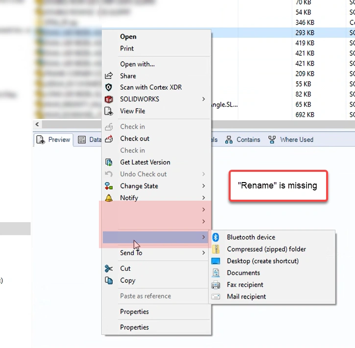

  4. For one group, I added the "Change State" icon to the Quick Actions toolbar in PDM. When I did this, it trashed the right-click menu (image below), some icons and text disappeared. When I reset t tohe quick access toolbar, things returned to normal behavior. Wow.
