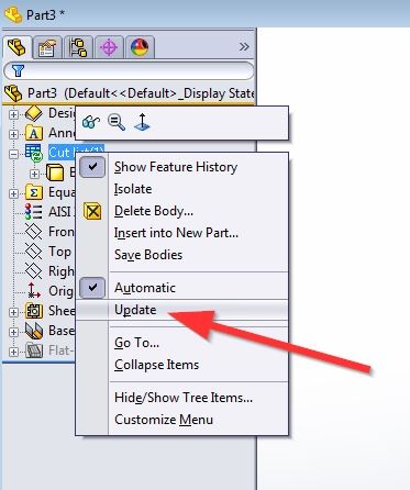

Update Cut-List set to "Automatic" but its not updating
Long story short, I am working on a macro that gets data from the Cut List properties (Perimeter, # of bends) and create a custom property of these values so I can export this to an Excel file.    Some of our weldments and assemblies have 20-30 parts, so Updating the Cut List manually on these parts is time consuming.  The Cut List "folder" is set to Automatic but the cut list doesn't update unless I choose "Update" in the RC menu.
Is there a way to do this automatically?

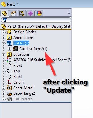

See attached screenshot.
SolidworksSheet Metal
Answers 2
JF
JF 2013-11-25 Best Answer
we don't do much with cutlists, but my understanding is that "automatic" just updates for changes to the existing bodies. if you add a body, then you need to rc and update to add it to the cutlist. I have no clue if that can be automated.
MM
MM 2013-11-26
You could add it as part of your macro. Obtain the cut list folder and use SldWorks.Feature.UpdateCutList.
