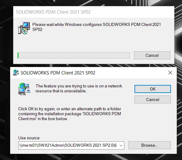

This is truly bizarre, so I will start with a screen shot of the error messages -

The error didn't start happening until I uninstalled SWX2023 SP2.0
The error happens when I attempt to open Windows Explorer or the Registry Editor.

My next thought was to save a copy of the 'SOLIDWORKS PDM Client.msi' somewhere that I can point to when the error happens.
Maybe if I can get it to 'install' I will be able to 'uninstall' it.

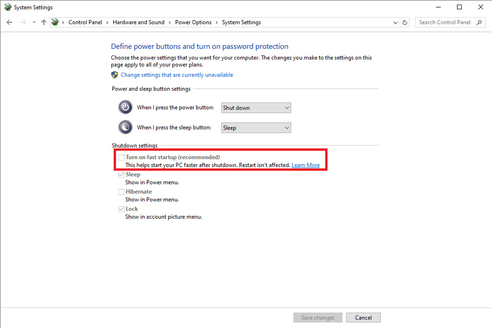

One of the things that is rolling around in the back of my head is the dreaded "fast startup" -
This option does not appear on the laptop that is having the issue.

Here's the scoop -
My idea of saving a copy of the .msi file to the machine, pointing to it when the message pops up, and letting it install worked!
(Very important tidbit here - it MUST be the version from the error message! I tried it with 2023 because I had those files already, but it didn't work. After downloading 2021, I was able to make it work.)
The next important part is that Add/Remove Programs did NOT see the files (even though they appeared in the start menu) which meant that I needed to use the Microsoft Uninstaller from the original post.
It was a very painful process, but 'tricking it' by letting it do what it wanted, and providing the file that it was looking for, made it possible to completely remove it.
