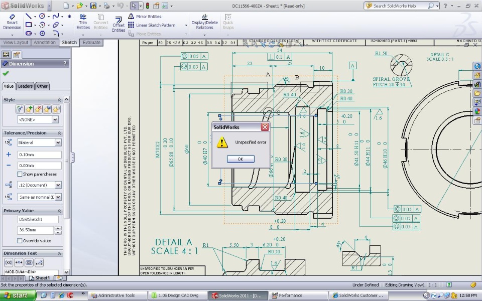

We are facing the critical issue of unspecified error in drawings. Sometime when we just click the dimension the error comes stating Unspecified Error and i have to cancel it 10-15 times and it comes on every dimension which i click.
This error remain untill i did not close that particular session.
Does anybody have faced this type of issue before?

The file is already created in SolidWorks with all the dimensions and checked in in EPDM vault.When Sometime we checked out the file to made some modification the error comes suddenly at that time i cannot do any modification in dimensions, when i click on any of dimension the error window comes and i have to cancel it 10 times around and it comes on any dimension which i click.
In both cases whether they are driving or driven dimension the error comes
If i will close that SolidWorks session then again open the file in SolidWorks then problem disappears. Somehow it cannot be reproduced again, it comes suddenly and much more related to the Current SolidWorks session.

There are 4-5 machines. We are running SolidWorks 2011 SP2.0.
M/c Specs are:
Windows XP 32 bit
RAM 2GB
Nvidia Graphics Card compatible.
The problems comes on any system at any point of time.and with any file. I have done this created the Rx File submitted the file to VAR but nothing works neither able to reproduce the issue after working with for so long.

Well, I know when I was at SWW2011 they emphasized that first 2011 will be the
last system that will interface with XP.  MS is phasing XP out. The other thing is
they would recommend a 64 bit machine.  The being said 32 still functions.  Looking at your
specs I would say, and this might speak to your other posting about your dims not auto
updating, is your memory.  2GB is starving the software.  4GB is the base minimum and you have
2.  If you are able to I would increase it to at least 6.  Then see if you are having the same issues.
