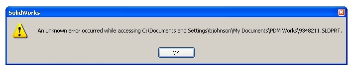

Hi,
I noticed a human error in a feature in one of my drawings, so I opened the part, corrected it and tried to save it.  After I clicked "save" an error window came up (please see attached .jpeg).  The part did not save.  The same error comes up when I try to re-save the part under a different name, and I can't save it to the desktop either.  Does anyone know how to fix this?
Thanks,
Brian

Try creating a copy of the part (using copy & paste method) , edit that copied part and see if you can save that part.

Ok, I did what Deepak said, but after having the part or the drawing open for a while, the error comes back.  I'll be able to successfully save it a few times, but the error comes back, and after that it will not save successfully.

Send that file to your VAR or SW team to have them fix the issue. The SW team has some kind of software/method using which they can fix the files.
