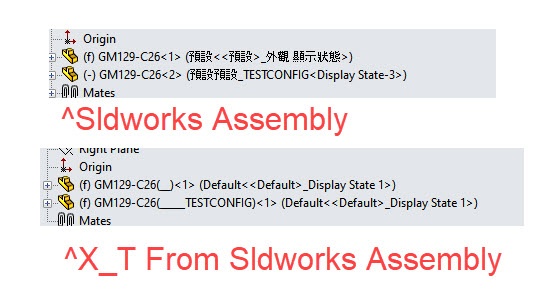

How do non-English Sldworks users here work with Parasolid (X_T) when Parasolid does not seem to support Unicode, non-ASCII characters?
Part of my job is processing Sldworks data from China / Taiwan via X_T Parasolid files, but it seems like only ASCII characters are supported with Parasolid files. All the unicode Mandarin symbols get replaced with underscores when I save an assembly out to X_T which means I'm losing important reference configuration or part name data.
Is there anyway to get Parasolid to respect Unicode characters or am I out of luck on this one? Tested with v27 and v31 of Parasolid between Sldworks 2015 & Sldworks 2019

Update! Long story short, although Solidworks can open up native assemblies and parts named with non-English languages, it cannot save to X_T, retaining non-English characters, without the appropriate Solidworks language packs installed. Turns out, the administrative images IT installed on my computer only included English.
Now, I'm able to save out my test assembly as an X_T, open the X_T up in a text editor and see the Mandarin symbols fine. The X_T opens up in Solidworks, retaining the Mandarin characters.
This is all well and fine, but still, opening up an X_T saved out by our Engineer from China, still yields question marks representing unsupported characters (I've installed all language packs I can think of on Windows that may relate to Mandarin.. Chinese, simplified Chinese, etc...). At any rate, mystery solved I suppose! Thank you all for the valuable feedback and information.

SolidWorks is definitely exporting the unicode as "???" in the text output. However, it imports the "???" as "___".  This is because SW creates files for each part when you import.  Windows filenames cannot contain "?".  Even though configs/features/etc. within SW may contain "?",  the exported file does not have a distinction between "component name" and "configuration" information.  The entire string just becomes the name of the imported part, therefore it cannot contain "?".
You might get better luck if you install either additional language packs in Windows, or possibly even a different language install of SolidWorks...  Can you ask some of your Chinese folks to go ahead and export to Parasolid from their OS and send you the X_T file?  You can check it to see if it's all ??? or not.

Maybe I didn't explain well enough. I understand the general limitations of X_T files, but what I was asking is if there is some magical way to allow X_T files to support Unicode characters. I'm needing to carry over the actual name and reference configuration name from assembly to X_T. See example photos below -
ASCII only from native assembly:
ASCII only from import X_T file derived from native assembly (notice how the naming of the ref config is baked in):
NOW, here the trouble starts when non-ASCII characters are being used. Examples below:
From native assembly (Mandarin used in configuration names. Works great.):
From import X_T file derived from native assembly (ALL Mandarin, non-ASCII gets replaced with "_" when exporting the Parasolid from Solidworks. This then is the result of importing the X_T in Solidworks):
