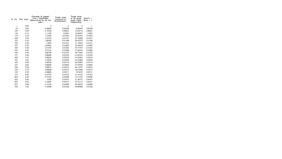

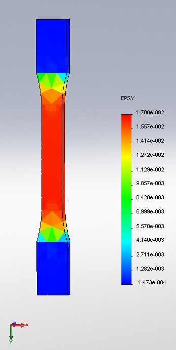

I have uniaxial test data for Polyurethane. I would like to input this test data into Solidworks, select a Mooney Rivlin 2 term curve fit and generate the test results. Finally compare these results with the initial test data.

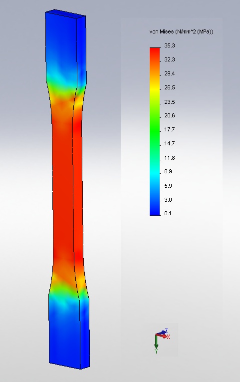

So far I could do all the steps except the final step. i.e. the Verification step. My model is predicting higher stresses than the stresses in the tension data. I am comparing the Von Mises Stresses versus the actual longitudinal stresses recorded in the test data.

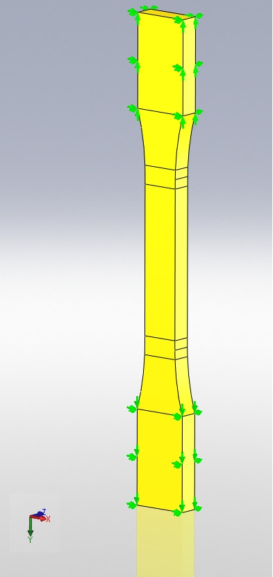

Please see the attached image for more details on loading condition and stress, displacement data. By the way, I am using displacement constrain and pulling the dog bone sample in two different direction using time v/s extension curve.
From Tension test Data:
at 0.2 sec, stress = 25.74MPa, displacement = 1.50122mm(total)
From Simulation Results:
at 0.2 sec, stress = 35.3MPa, dispalcement = 1.5012mm(total)

what was the strain at the time 0.2 sec? The two term model will diverge from the test data at higher strains.

Strain is 0.017.
WIth just uniaxial tension data in hand, I thought I can only go with a two term Monney Rivlin material.

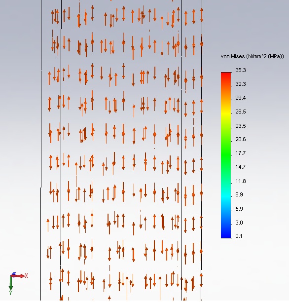

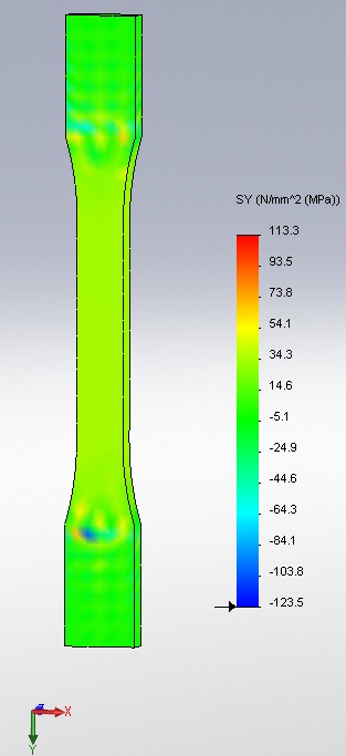

The region within the guage length has only tensile stresses. So shouldn't the von mises stress = stress in Y?

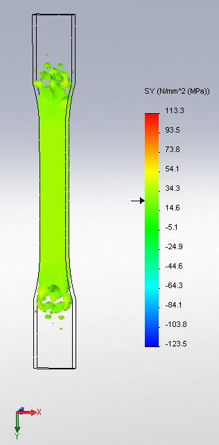

Here are the two images; one with a vector plot for von mises and other is the Stress in Y direction. Both are within the gauge length region. Here the stresses in Y direction are almost equivalent to the test data.
The third image will show that higher stresses are produced by the model for stress in Y. I am not sure why this is happening. I was expecting higher stresses in the gauge length region. But the model predicts higher stresses in the region where there is a sudden change of boundary condition. i.e. the region between the gripped and non-griped portion.

strain is really low. Answers should be close.
Oh, did you put the curve data in in terms of stretch ratio vs. stress? that is what the program is expecting.

Yes, I did input the Stretch v/s stress data. (Stretch = Strain + 1)
As I replied earlier, the stress in Y looks similar to the one I got from test data. But again, this was only the stresses in the gauge length section (2inch). I found this by using the iso-clipping option. The actual stresses in Y direction exceeded the stress values at the gauge lenth section (110MPa > 28MPa).
I always had issues with the mesh quality of Soildworks. I am observing higher stresses at the intersection of the buodary condition sections (area where the grip is used).
SF
SF 2010-09-01
the test data is only giving you the average. Ask the model to give you the average - split the part into two chucks so you have a surface upon which you can get the average. the peaks at a BC can be due to the idealized BC.

if you don't want the noise you have to move the BC to somewhere where you can tolerate the noise - they are infinitely stiff in the directions specified. Put in what is in the real world (might be the clamps in the test rig) and move the BC back and remember what you are measuring.

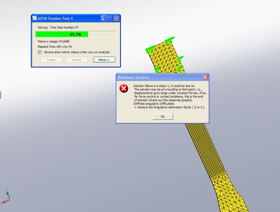

Now I get his error mesage with solution failure. I am not sure if I am really exceeding the limits here.

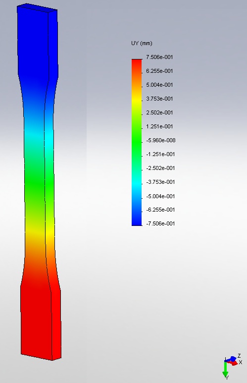

I used stress v/s stretch data as input for simple tension data in Mooney Rivlin material with 2 terms.
I used the extension v/s time data in the displacement constraint. The two gripped surfaces were pulled against each other with half of the total extension amount from actual test data.

I solve finish. I used under condition symmetry. I read journal ASTM 638. Please look attached file.
