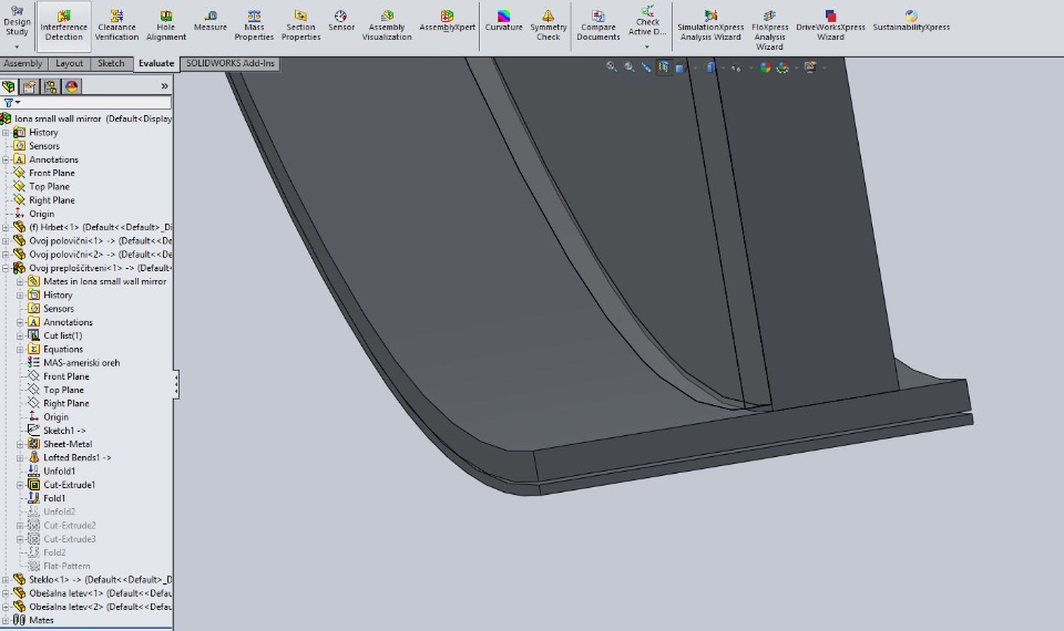

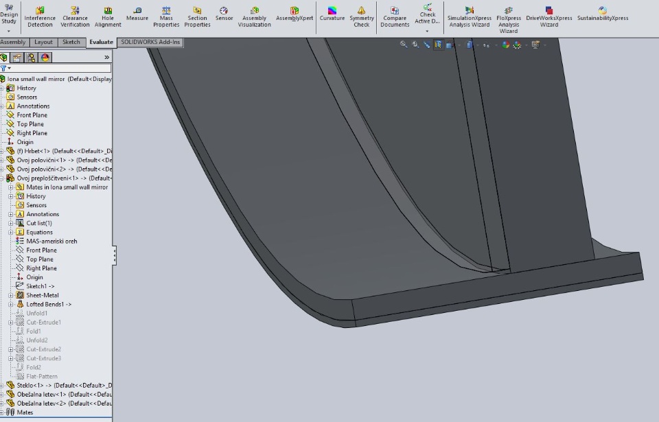

Dear all,
I have a problem while after folding the sheet metal doesn’t return into the same position as it was before I made unfolding. Below are the pictures for better understanding. Can somebody help me and explain why this happening and what I’m doing wrong? What do I have to change when doing unfolding so after the folding material will go exactly into the same position as it was before?

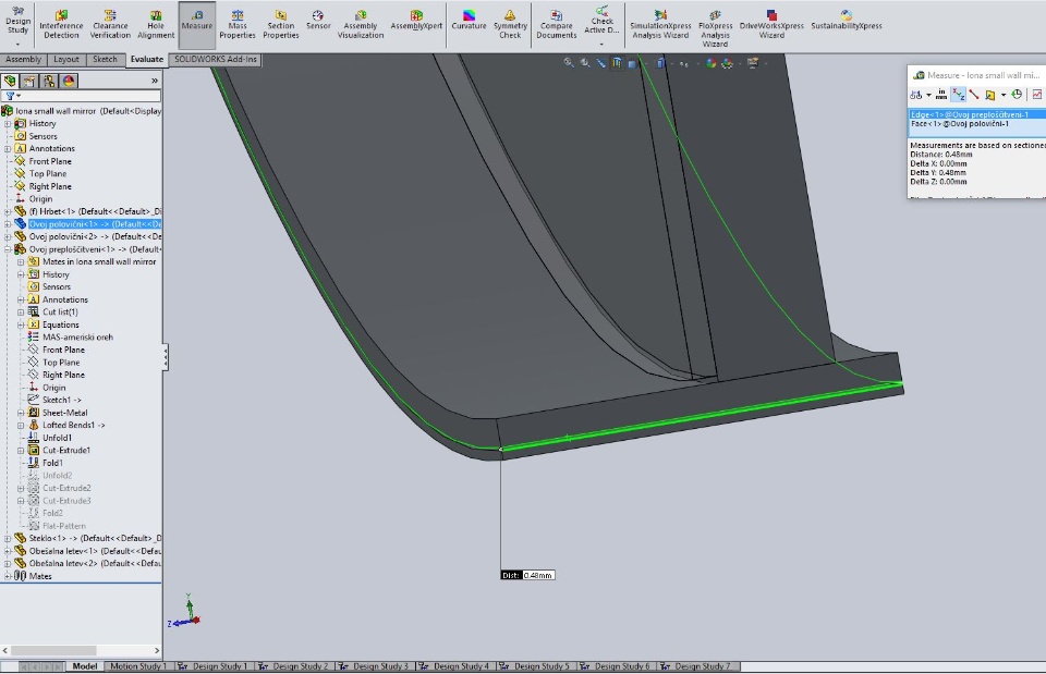

It's hard to tell from the pictures.
Measure before and after to be SURE that they are different.  Just because they look different may not be the case.  SolidWorks does not display small differences well.
You don't show us the unfold operation.  How do we know that is working right.  It looks like you have a large radius?
Why all the folds and unfolds, usually these aren't necessary except in rare instance.  These features are used a lot by inexperienced modelers.  Especially telling is that you use it repeatedly on what looks to be the same final profile.

Hi,
Unfortunately I can't post my part file. Below is the picture of fold and unfold operation. There is nothing to set up. The sheet is curved on ellipse (size 600x900mm). I'm doing all the unfold and fold operations while if I do all the cuttings at once folding is not possible any more (I come an error when try to fold). There was a lot of questions on this forum about that but without answer. That’s why I made partial cuts to solve that.
