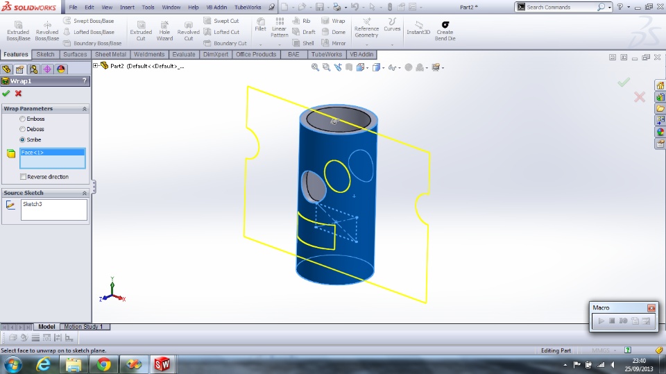

When using the wrap feature to scribe a sketch onto a cylindrical face, a yellow highlight appears on the screen representing the cylindrical face, unfolded onto the 2d plane. (Picture attached).
Does anyone know if there is an API object to do this?

KR 2013-09-26 Best Answer
Ali,
That preview is part of the wrap feature so if you want to see that preview then you have to use the wrap feature. If you want to program a similar preview for a program you are creating, you may have to use OpenGL. That's how I'm guessing the preview does it, though I'm not certain.
Keith
