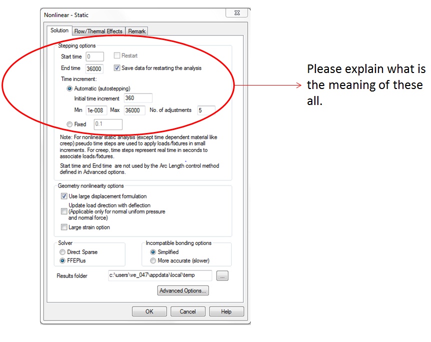

Hi, i am new to this solid works simulation, I wanted to conduct a creep analysis. I could not make out what is the meaning of the time increment and sub sequential .please explain what is following parameters. i.e Initial time increment , min ,max, No of adjustments

Think of a stress-relaxation curve and how you'd want to distribute your time-steps along it; you want finer steps to start with since you're in the primary phase of creep (you have a lot going on initially) and your step size to increase as during the secondary phase of creep.

Thank you Shaun for replying, Can you please elaborate this, still i have confusion.
