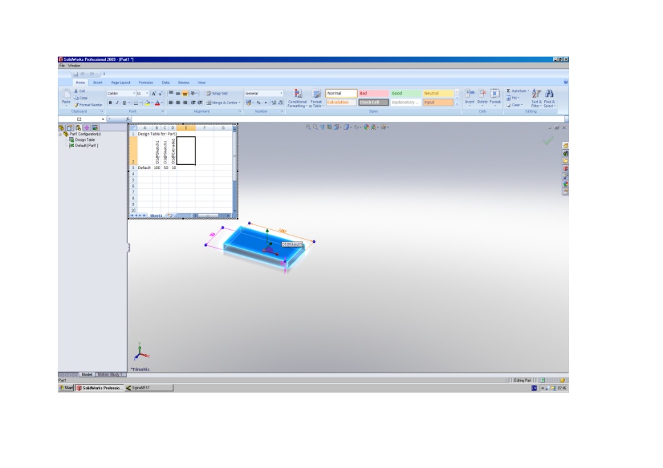

Hi Lindsay,
Attached is a couple of screen shots of a very basic shape driven by a design table.
Create you shape & dimension / extrude to thickness.
Go to Insert ---- Table ---- Design Table. Use Auto create. Select dimensions you want to control.
An Excel table will appear with sketch / extrude dimensions (or the ones you selected).
Alter a dimension and click outside table (this will close table) the part will update to new dimension.
To see table again go to Configurations in Design tree, right click Design Table, edit table.
Hope this helps.
In the screen shots i altered D1 @ sketch1 from 100mm to 250mm. After closing Excel table, part updated to new length.
